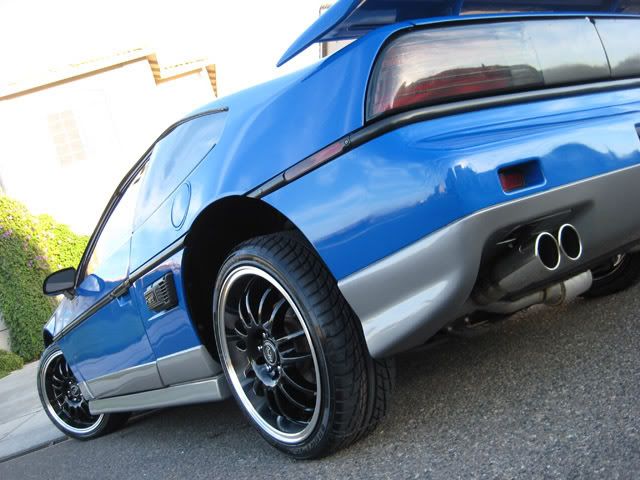

So I am about to buy the Eibach Lowering Springs for my 87 Fiero... And I was wondering If I will have to change anything due to it bieng lower? Like having to change the shocks and struts. Please If anybody knows I would like to find out as soon as possible. I want to get them on my car soon. And Is it hard to install them? Is their a site that shows a step by step procedure on how to do this?
Thanx
As you can see my fiero desperately needs to be lowered :P Too much wheel well
