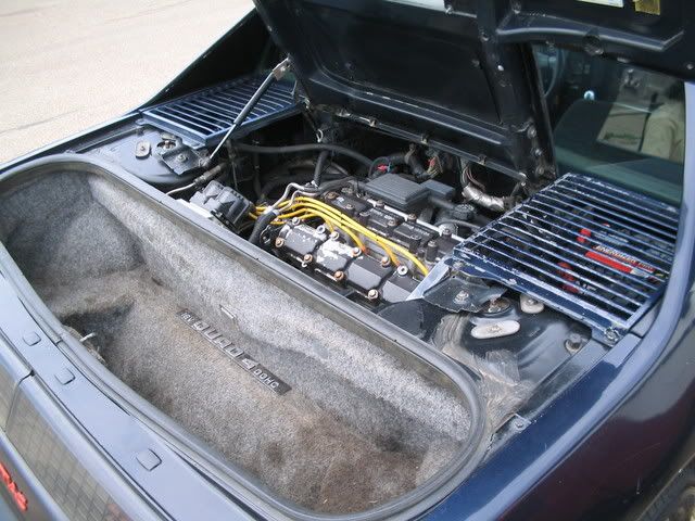

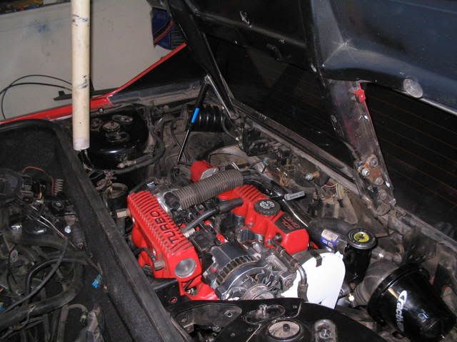

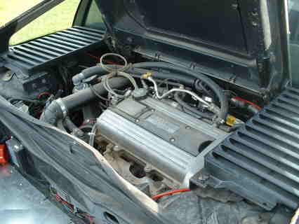

We have an earlier version of that engine in my dads Fiero, 87 2.0L TBI, all shined up, with an isuzi 5-speed. Got into the 40's for mileage easily.
It is being replaced by this, this winter:
The engine is actually designed by Opel, and is the grandfather of the Ecotech. It was actually called the Ecotech I in europe, they later came out with an Ecotech II, and the current Ecotech which is the one that GM is currently using here is the 3rd generation Ecotech.
And if you like the DOHC 4 cylinders:
My Quad 4
I have worked on a 03 N* in a Fiero, and it actually isnt too bad to work on everything below the valve cover is easy to get to from below, and everything above is easy to get to, all DOHC engines have the spark plugs going through the middle of the valve cover into the middle of the head, so they are pretty much on the top of the engine, and easy to get to, pushrods engines plugs come out the sides, which makes them alittle harder to get to from the top. I have not worked on a stock 2.8L Fiero with the engine in the car, but my Quad 4 is easier to work on than my 2.5L Fiero. The only thing that is harder as far as general maintanence is changing the oil, because the oil filter is on the front of the engine, I have to jack it up, where my 2.5L filter can be reached from above.
