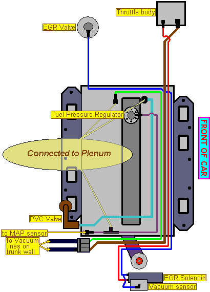

i need to know where all vac lines go

Here is the vacuum diagram: The only one not listed is for the brake booster.
