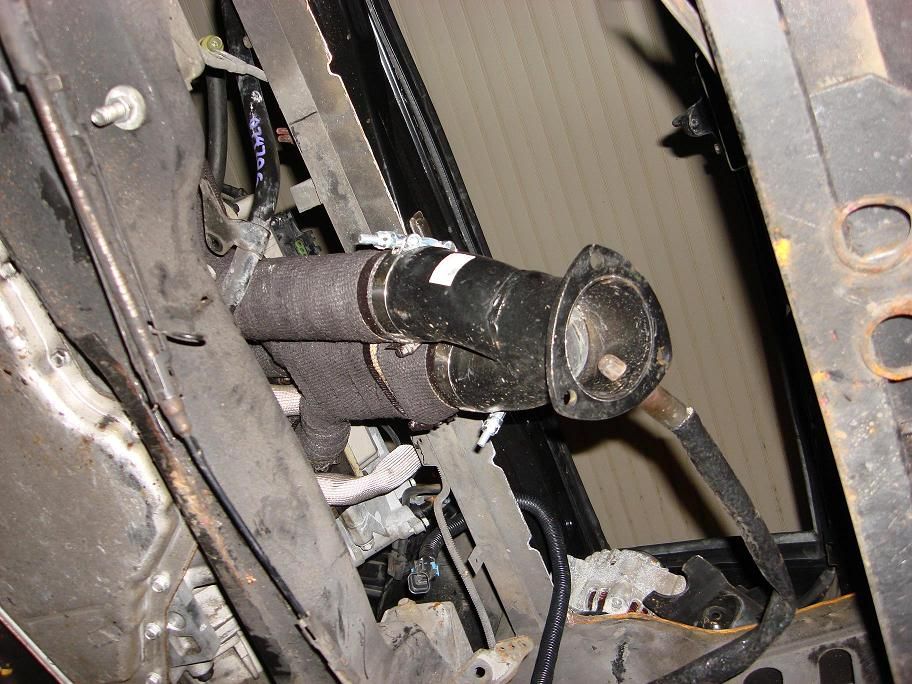

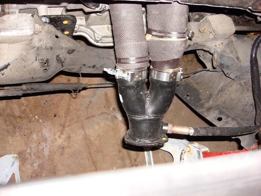

Nothing too major, highly doubt you will be keeping a full sized trunk with them.
I have a picture around here somewhere. I can get it later.
Basically the outlet comes just behind the rear cross member, almost as high as it. It would be possible to make a custom collector back there also.

Report this Post10-30-2007 11:14 AM Click Here to See the Profile for Billybo455Send a Private Message to Billybo455Direct Link to This Post
holy crap. you have to get pretty crazy with exhaust!!!! i'll post a picture of mine! if can be done, but you don't have much room to work with. and say good bye to the trunk.

Report this Post10-30-2007 01:39 PM Click Here to See the Profile for Billybo455Send a Private Message to Billybo455Direct Link to This Post
i wish you luck my friend. those pics are about 3 weeks old. i need to go take some new ones. i have a camaro style muffler mocked up now and everything tacked. it wasn't really hard to do, but you do have to sit back and think about for a few minutes :P i got the pacesetters because i wanted huge almost useless primaries!!! post some pics when you get your exhaust done.

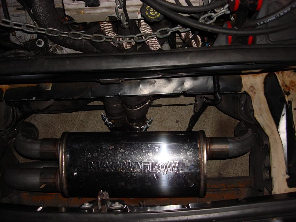

Billybo455
Posts: 529
From: FL
Registered: Dec 2006
Total ratings: 85
Report this Post11-11-2007 06:54 PM Click Here to See the Profile for Billybo455Send a Private Message to Billybo455Direct Link to This Post
well i figured i'd give you guys an updated picture.
darkhorizon
Posts: 12279
From: Flint Michigan
Registered: Jan 2006
Total ratings: 451
Report this Post11-11-2007 10:45 PM Click Here to See the Profile for darkhorizonSend a Private Message to darkhorizonDirect Link to This Post
looks identical to my friends magnaflow setup
Billybo455
Posts: 529
From: FL
Total ratings: 85
Report this Post11-12-2007 01:51 AM Click Here to See the Profile for Billybo455Send a Private Message to Billybo455Direct Link to This Post
only took about a hour and a half to mock it all up. pretty simple.
