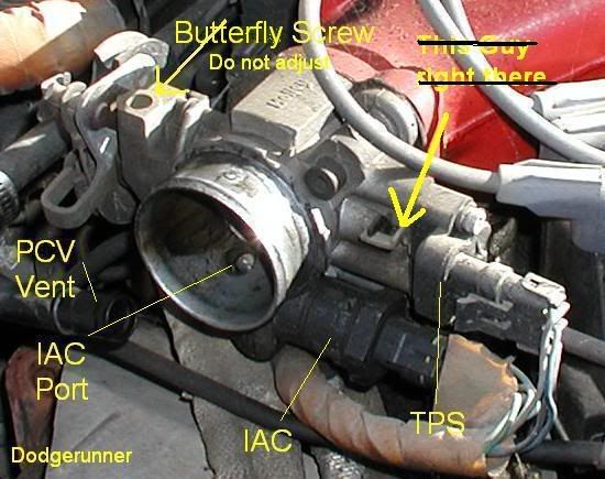

MordacP
1300 posts
Member since Sep 2007
Edited version of pic

The black pipe in the bottom right of the photo is where the air goes from the IAC port. There should be a small o-ring inside the throttle body hole that seals the pipe into the throttle body. The other end goes down to the intake manifold. If any part of that leaks it will cause a high idle.
EDIT: I just saw your 2nd post and yes it goes into that hole. Make sure the o-ring is in that hole too.

Look inside the hole on the throttle body where the black pipe connects and see if the o-ring is intact. Also wiggle the black pipe to make sure the rubber hose is tight. Another member had a high idle for years before tracing it to the metal pipe under the rubber hose. It had become loose over the years. It does not take much air to cause a high idle.
Here is what the black pipe looks like with everything out of the way.

Ohhh Hudini, I'm going to grab a copy of that picture. That will be handy. With credit ofcourse...
