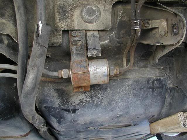

One way to drain the fuel is disconnect the filter (replace it too) and run the fuel pump through the aldl connector hooked to 12v.
The distributor has an o-ring that can leak. It could also be coming from the bottom of the lower intake manifold but that is much more difficult to fix. With the dist you mark it's position relative to the engine and also mark the rotor relative to the dist itself. Remove the 15mm bolt on the hold down thingie. Pop the dist out and replace o-ring. Replace dist so that your marks line up. Do not turn the engine while the dist is out.

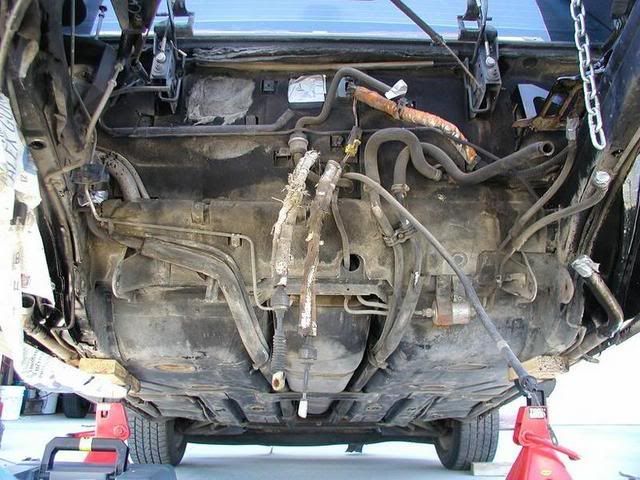

Hudini
Posts: 9030
From: Tennessee
Registered: Feb 2006
Total ratings: 165
Report this Post09-25-2007 11:50 PM Click Here to See the Profile for HudiniSend a Private Message to HudiniDirect Link to This Post
At the filter. You really should replace it too. Use PB Blaster to loosen the rust. Flare wrenches help to not strip the fittings.
Photos courtesy of Dodgerunner:
