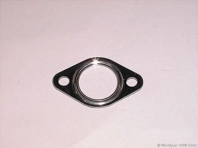

The best are actually for a volkswagen beetle:
I bought the 3.4L ones, snipped the extra piece between ports, and hung them on the studs. Then it's easy to put the manifold on with them in place.

Excellent post you have hudini,,what year are the volkwagen gaskets from I had ask at a v w performance shop and they did not know what i spoke of

I believe it was a '62. I will try and find the link.
http://www.autohausaz.com/s...836@Exhaust%20Gasket
