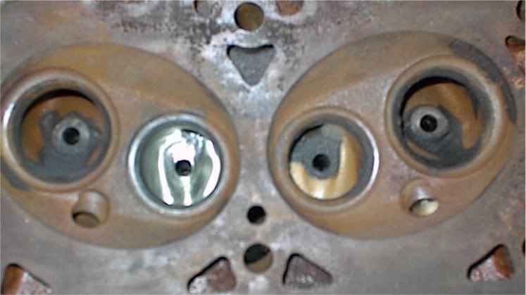

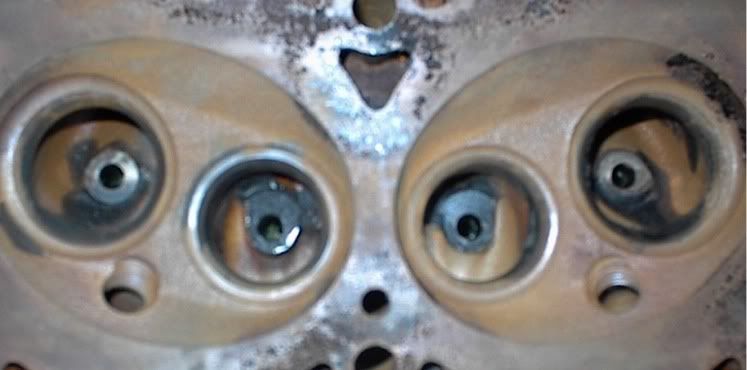

Report this Post09-23-2007 12:14 PM Click Here to See the Profile for 84BillClick Here to visit 84Bill's HomePageSend a Private Message to 84BillDirect Link to This Post
84Bill
21085 posts
Member since Apr 2001
Before
After
[This message has been edited by 84Bill (edited 09-23-2007).]

Report this Post09-23-2007 07:04 PM Click Here to See the Profile for bmaxboxSend a Private Message to bmaxboxDirect Link to This Post
Looks good to me. lol, i got a new head a few months ago with new valves, springs everything. It looked really nice. I wish i ported it then.

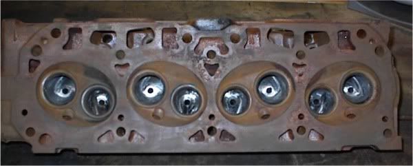

Report this Post09-30-2007 11:41 PM Click Here to See the Profile for 84BillClick Here to visit 84Bill's HomePageSend a Private Message to 84BillDirect Link to This Post
Almost done grinding...
pic to big
[This message has been edited by 84Bill (edited 10-01-2007).]
bmaxbox
Posts: 514
From: ohio
Registered: Jan 2007
Report this Post10-01-2007 02:51 PM Click Here to See the Profile for bmaxboxSend a Private Message to bmaxboxDirect Link to This Post
resize it! i wanna see
84Bill
Posts: 21085
Total ratings: 461
Report this Post10-01-2007 05:30 PM Click Here to See the Profile for 84BillClick Here to visit 84Bill's HomePageSend a Private Message to 84BillDirect Link to This Post
