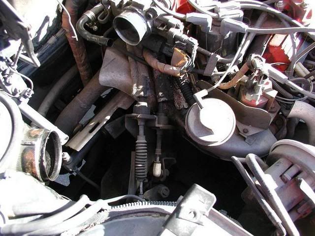

Dodgerunner
Posts: 9687
From: Lincoln, Nebraska
Registered: Sep 2004
Feedback score:    (61)
Total ratings: 323
Report this Post09-24-2007 03:46 PM Click Here to See the Profile for DodgerunnerClick Here to visit Dodgerunner's HomePageSend a Private Message to DodgerunnerDirect Link to This Post
Here is what the one on an 85GT looks like.
Mounts with two tabs on the slave bolts and one on a bell housing bolt.
Barkaroo
Posts: 100
From: Dacula, GA, USA
Registered: Apr 2007
Report this Post09-24-2007 04:21 PM Click Here to See the Profile for BarkarooSend a Private Message to BarkarooDirect Link to This Post
Thanks so much for the photo!
No such animal on mine.
Is that an exhaust manifold just forward of the heat shield? Not sure if there is an exhaust pipe that close to mine…. I’ll have to look when I get home and I'll let you know.
Thanks again for all your info and support.
-Alan.
fierofool
Posts: 12964
From: Auburn, Georgia USA
Total ratings: 154
Report this Post09-24-2007 05:16 PM Click Here to See the Profile for fierofoolClick Here to visit fierofool's HomePageSend a Private Message to fierofoolDirect Link to This Post
There is a manifold that close to yours. The pictures I emailed to you are of an 87, just like yours. I think there may be a little difference in some of the heat shields from different years, though I believe all will fit. Check back with Ashby or Don to see if they have a shield. I emailed you a temporary solution, along with the pictures.

Alan, I had a similar problem on my 88 Notchie with a 3800 SC and Izuzu 5 speed. The only cure was to replace the master and slave cylinders and bleed the hell out of it. Things now work much better after the new parts.

Originally posted by Barkaroo:
Thanks Indy.
I'll take your advice and order a new Master today and try that. Have you ever seen a problem like this? It is just so strange that it works fine for the first 45 minutes of driving and then it goes south on me. Once it cools down for 15 minutes... it seems to work fine again for a while.
I've been able to bleed some that worked for 5 minutes, 5 hours, 5 days, 5 weeks. . . . . you get the idea.
I have several manual trans cars, coupes, V-6's and various years.
Like I said in my first post, mine was doing the exact same thing, changed them both cleaned dirty line and shifts like new.
Should I bother with checking the transaxle fluid level? I could not pull the speedometer fitting out last night to check it. Is there a trick to removing it? What are the odds that the transaxle fluid is part of the problem anyway? How often should the transaxle fluid be replaced if ever? I could not find it noted in my Haynes book. The car has a total of 76,000 original miles. No leaks. Major tune-up was done in March and the car runs smooth as silk otherwise.
The 88 getrag has a dip stick on the opposite side on the speed sensor. Some unscrew and some have a theromos type stopper type. Other than that a small amount of prying maybe required, use the lockdown groove to do so.
Thanks Joseph.
I'll look into the linkage tonight. By the way... no gear grinding issues.... Except when it was pushing the car out of 2nd gear that first time. I have not tried to force it in 2nd again after that.
Thanks, -Alan.
I don't think you have a linkage problem, more cause than effect that you were not fully in 2nd gear is why it jumped out of gear.

did you get a chance to try my "quick master test"?

The brown color of the clutch fluid is the first clue. It's due to rust in the fluid; the fluid has absorbed moisture from the air, enough to rust the inside of the lines.
That moisture is also the root cause of your problem - when the slave cylinder gets hot enough to boil water, the moisture turns to steam and blows the fluid out of the slave. Result: no clutch. When it cools down the steam condenses and everything is "OK" again.
The cure will take a couple of hours - but it'll put things right. Start by disconnecting the clutch line at both ends, remove the bleeder from the clutch slave and the cap from the clutch master. Next, flush everything out with denatured alcohol (methanol) - you can get it at your local hardware store for about $15 a gallon. Keep flushing the cylinders and lines until it comes out clean, once isn't enough. The methanol will absorb any moisture left in the system as it cleans out the rust deposits. I like to put the can of alcohol in the trunk and run a hose from the clutch line into the can. Then I use a vacuum bleeder in the back to pull alcohol through the line.
When everything is clean and sweet, blow the line and cylinders out with dry air. Hook the lines back up and refill with clean fluid from a new container. That bottle of brake fluid that's been on your shelf for a while isn't any good anymore; throw it out and buy a new bottle. I use DOT-5 Silicone fluid in my clutch; works great, you could do the same and avoid future problems with moisture.
Bleed it well and you'll have a clutch that works reliably again. And after seeing what this did for your clutch, take a look at your brake fluid...

Finally m86gt,
I did not get a chance to yet. I work a good ways from home and by the time I pull in the driveway it is dark and I am tired. Besides it takes an hours worth of driving to recreate the conditions before I can conduct your test. I plan to give it a try this weekend and will let you know. Thanks.
Whuffo,
That really sounds about right to me. Excellent suggestions that I will try. I think I'll go ahead and order the master cylinder so that everything is new and then perform your "cleaning" procedure.
I'll let you know how it turns out.

Update 12/13/2007
Sorry for the delay but better late than never right?
I put on the new master, blew out the line, and put it all back together, drove the car.... and still had the problem.
I called my mechanic (Ashby) and he suggested an optional solution. He suggested replacing the stock slave push rod with a longer one to give it more reach. I cut an 1/8" longer rod from an old valve and switched out the stock rod. It raised the friction point on the pedal a little but other than that it seems to have taken care of the problem. The cooler weather may also have played a factor so I am going to have to keep an eye on it for now.
Thanks again for all the advice. I really appreciate everyone's help.
