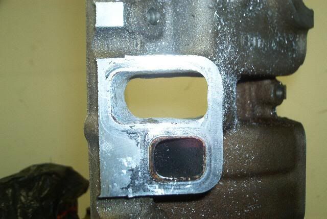

When I replaced the lower intake manifold gaskets on an '85 S-10 Blazer with a 2.8L engine, the block off plates were there (had a small hole in the plate you either plugged or left open) as the heads had open ports to feed EGR gases to that model 2.8L engine's intake. The EGR valve was located on the intake manifold by the carburetor. The Fiero does not use this provision though. Look at the lower intake manifold. The spot that mates up to the head is a little indentation that goes nowhere. The bottom line is that block off plate is not needed on the Fiero.
Here is a close up pic of the lower intake. You can see it is a dead end just to the side of the port.

The extra exhaust port is for engine variants that take the egr exhaust from the intake manifold. The Fieros get it from the exhaust cross over pipe. The manifold doesn't have a passage for the gases to go into so you don't need the blanking plate. For sealing effectiveness what matters is that the head and manifold surfaces are clean and flat, and that you use a good sealer, and that you don't cut the gasket to fit around the pushrods.

Thanx Hudini & Jazzman, I just didn't want to burn through the inlet manifold and trash it!! You agree with the Tech guy at Fierostore, it was just the guy in The UK that worried me.
