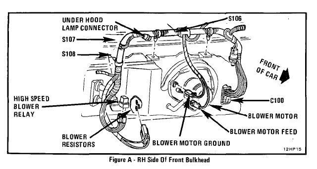

There are 2 types of heater cores also. With A/C and without. The ones without A/C take about 30 minutes to change. Those with A/C take longer. (if it's leaking and not the blower motor or resistors.)
Here is a pic of the front compartment showing resistor and blower location:. The heater core is behind this area.
