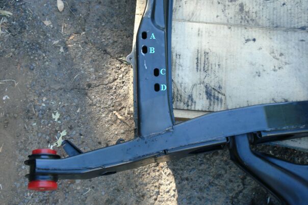

Which holes am I useing,for the tranney mount pictured (3800 SC serie II)?It's either A & C or B & D?Allso on the poley bushing pictued,there is a metal sleeve insert that came with the poley,their larger than the Fiero sleeves,so which ones do I use?

a&c -- fairly certain, but are those the ones you drilled out? whichever ones you drilled out are the ones you use.
no idea about the poly

A C is automatic
B D is manual
i never got any poly with outer metal sleeves... I just burn out the old rubber, polish the remaining sleeve in the cradle and insert the poly.. push in the ID metal bolt sleeve.
