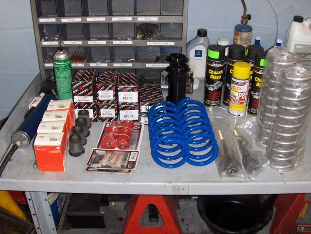

Here is the parts list:

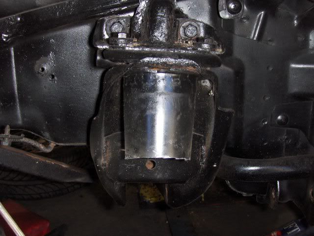

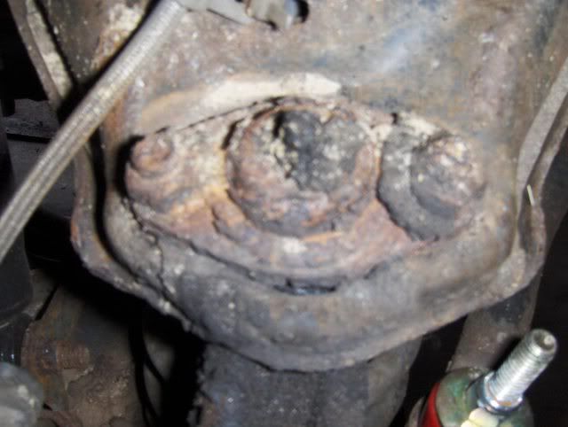

So far, all four rack mounting bols have broken upon removal, and I have half the arms for the car done.
I was hoping to have this thread more technical describing the proper procedure for pressing out the bushings for a DIY'er, but I find myself using the hammer and chisel as well as a bench vice opposed to using a 20 ton press.

Why does every damn bolt have to be seized or just break off???????
I'm so not used to working in these conditions. I can take apart a 1959 Mercedes and not have one bolt give me problems. Geesh!

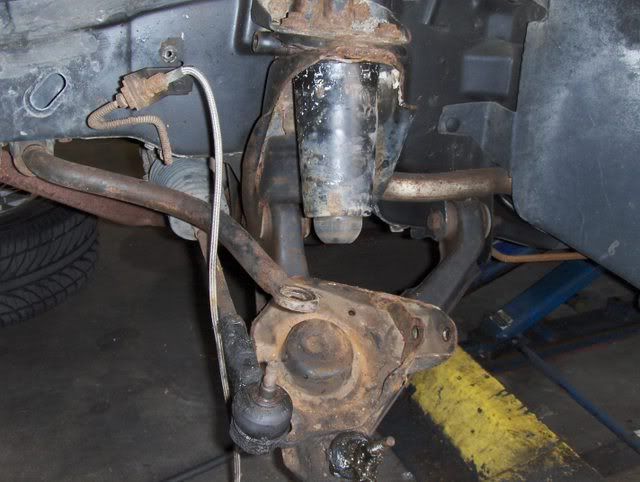

Anyway, here are some update pics. I have about 10 hours invested so far.

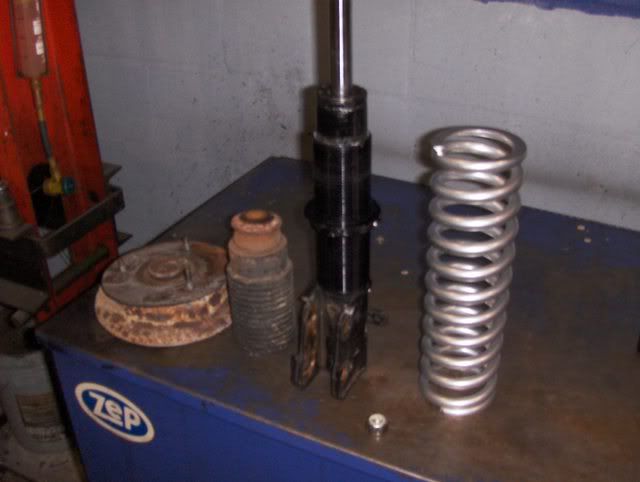

By the way, if you guys make coil overs...STAY AWAY FROM THE BILSTEIN SLEEVES!!!!. I used Afco sleeves on my last set and they fit great. The 2" Bilstein have a ridge on the inside that I had to hone away.

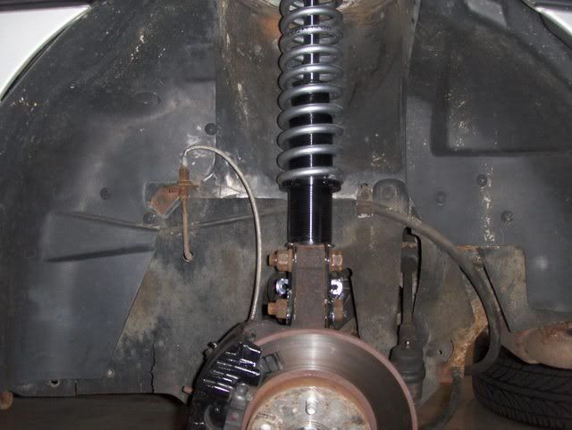

I had the chance to finish the rear coil overs today. Note: don't use Bilstein sleeves because they have a ridge that must be honed out from the inside. The AFCO ones are much easier to use. So, I honed out the interior of the sleeves and ground off the spring perch (note-keep the strut cool to prevent seal damage).
I used a 275lb spring rate. My V8 has the 300lb springs, so I figured I'd try a little lighter for the VR6....I can always change them later if I am not happy.

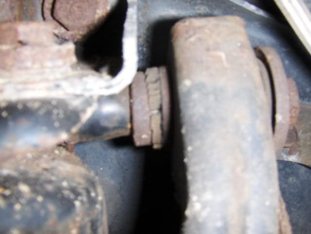

Report this Post09-20-2007 07:04 PM Click Here to See the Profile for Russ544Send a Private Message to Russ544Direct Link to This Post
Wow. is that a "normal" amount of rust for your area?
Russ544
That's about right for a car that is kept outside. When I bought the car, the cradle was almost rotted in half. The key areas such as the trunk and floor are in good shape. My GT is garage kept and has very little rust.
Strangely, my last 86 SE V8 had no rust whatsoever, kept outside and I lived a mile from the beach.
go figure.

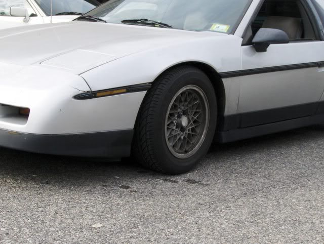

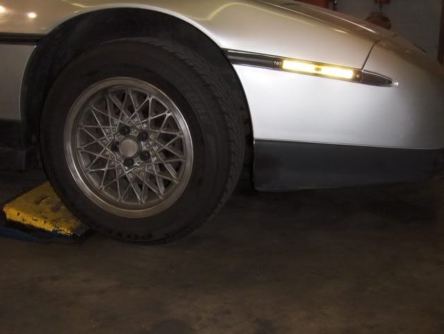

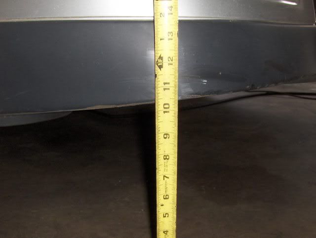

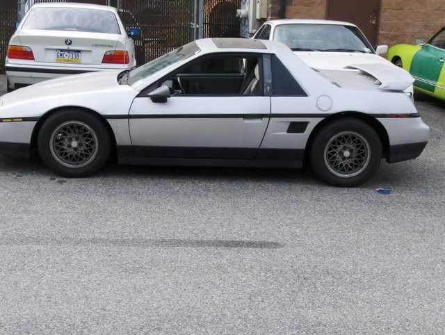

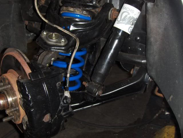

ok ok ok....the car is just about done. I'll finish the hardwood floor asap. Finished height in the same location as before is now 7.00 inches and 7.25 inches front and rear.
Monday it is getting aligned by a local body shop and then the 18" rims are going on. Here are some update pics. I'll post final pics with the rims once it is all said and done.
Dave

Report this Post09-28-2007 10:57 AM Click Here to See the Profile for NYRED85GTSend a Private Message to NYRED85GTDirect Link to This Post
Whoa I like! Where did you get your front lowering springs? I need some for my 85'.

I got them from WCF.
Personally, I like the suspension techniques from Summit a little better (on my GT). The reasoning is: Suspension Techniques springs are longer so you don't have to cut the bump stop. WCF springs are shorter (making install easier), but have a higher spring rate...thus requiring cutting and welding the bump stop.
I can't say which ride better. The car is getting aligned Monday and Tuesday I'll have the finished pics (with rims) posted if all goes well.
Dave

Report this Post09-28-2007 03:36 PM Click Here to See the Profile for bmwguruClick Here to visit bmwguru's HomePageSend a Private Message to bmwguruDirect Link to This Post
WCF sells just the front. I called them and they do list it on their website. It is a little hard to find, but they do sell just the front.
I noticed that both my Fieros have 1.5" lowering springs, but the drop difference is drastic. The SE pictured above won't go on my trailer without tearing the nose off. My GT will go on with ease. If I run into more issues, expect to see these springs in the mall.
On a good note....they look pretty sweet.

Report this Post10-01-2007 06:38 PM Click Here to See the Profile for bmwguruClick Here to visit bmwguru's HomePageSend a Private Message to bmwguruDirect Link to This Post
Car is at the alignment shop. They should get it back to me tomorrow if all goes well. Hopefully, this alignment will cost less than I paid for the car. Most shops just toe and go. I told them to get the caster, camber and toe within 1/4 of the allowable tolerances and no cross caster or cross camber.......my damn OCD is kicking in again.
Dave

Report this Post10-02-2007 05:38 PM Click Here to See the Profile for bmwguruClick Here to visit bmwguru's HomePageSend a Private Message to bmwguruDirect Link to This Post
ok, I wanted to post a final update on the car.
First off, the alignment came out great....and only costed me $195.00
Second, the springs from WCF will be put in the garbage this winter. I won't resell them in the mall because I don't want anyone getting pissed off at me. I'm going to use the 1.5" suspension techniques springs. My reasons are: my 18" rims rub the wheel wells on my SE with the WCF springs. On my GT, I have a nice lowered look with no rubbing...same rims and tires. I thought I almost lost my front bumper about 8 times on my drive home. My GT gives me no isues on the same roads. The ride quality is that of a Honda slammed to the ground....very bouncy.
Not pleased.
So, we will be doing a spring swap this winter. In the meantime, I'll deal with the rough ride....and stock rims
Dave

Do you know the spring rate between the two? Is it that they are just shorter or is it they are too soft? If you find a vendor of the fronts then please post it. I have to write JCWhitney and yell at them some more for putting things on their web site and not selling it.
Mike

Report this Post10-03-2007 08:08 AM Click Here to See the Profile for bmwguruClick Here to visit bmwguru's HomePageSend a Private Message to bmwguruDirect Link to This Post
The front springs have a 350 rate. I could shim the springs, but I'd rather go with the set that I know what the ride is like, but right now they are on backorder from Summit Racing. I'm going to google to see if I can find another vendor.
Summit Racing has everything needed to make the coil overs.
Dave
Dave
Let me see if I understand you correctly here. The suspension techniques springs you have are lowering springs? If so, do they sell them at Summit for just fronts and do you have a part # ?

Report this Post10-03-2007 12:36 PM Click Here to See the Profile for bmwguruClick Here to visit bmwguru's HomePageSend a Private Message to bmwguruDirect Link to This Post
I have to look up the number, but they sell all four. I'll just sell the rears like I did last time. The ride quality is excellent and it is still lowered, but so much to scrape the front bumper. Here is a pic of my GT with the Suspension techniques springs.
