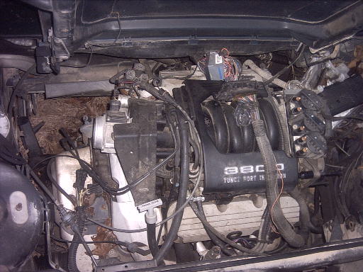

It does look nice sitting in the car

craigsfiero2007:I have a 1986 Buick Regal with a 3.8 Liter it has the original carb. on it. Carbs. were not discontinued until 1989. They switched to throttle bodies then. The only engines that had throttle bodies on them in the early 1980's were the four cylinder engines. 3.8 liter will bolt up to the Fiero Tranny. It has the same bolt pattern as the 350.
The engine & tranny pictured above (along w/ the ECM & part of the harness) were from an 1988 Buick Park Ave. SFI rules!
