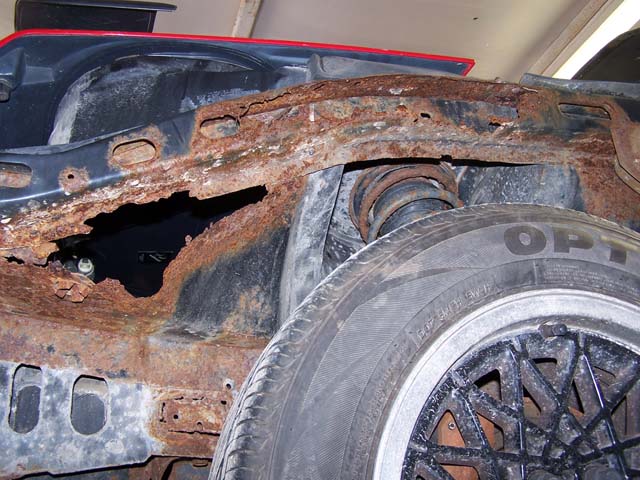

Check the space age frame behind the trunk carpet.
You don't want to see this!
This is with the rear panels off the frame, but if you pull back the sides of the trunk carpet you should be able to see if there is rust present.

Is this rust due to the climate the car is in or does it simply happen? I'm a bit worried on mine because I've never checked for rust :\ So I don't know what I might find. The one thing I do know is that the car has been purely a California Bay Area car and has never left the Bay and has excellent service records from the P/O. So I'm hoping against hopes for the best.
fierobrian
Posts: 2976
From: aurora il 60505
Registered: Sep 2003
Total ratings: 80
Report this Post09-05-2007 07:17 PM Click Here to See the Profile for fierobrianSend a Private Message to fierobrianDirect Link to This Post
the salt air is a huge factor . SALT AND WATER ARE THE BIGGEST THING stick you hand over the rear tire and up by the sturt if you feel rust check it out
Ouch! I have Fieros I'm cutting up for scrap that look better than that. If you can find a car that has spent most of it's life in a warm climate. Rusty cars like the one pictured are RARE around these parts.

WOW that is some rust alright! I'll be on the look out for that.
