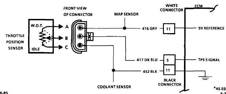

And im pretty sure my throttle position sensor is bad, but i dont know how to check it.
(see this topic for my description of the TPS problem https://www.fiero.nl/forum/Forum2/HTML/085322.html)
could you maybe tell me where it is and how to check it?
I dont know, i have several problems, all frustrating, W/e help u can give me is appreciated.

You can check the TPS with an analogue ohmmeter by placing the leads on the (very tiny) pins on the tps. Then open the throttle slowly and watch the ohmmeter for any big jumps or dips. The digital ohmmeters don't work as well with this test. The cool thing is a new TPS is about $20.

See we used a digital ohmmeter today to check thats a good idea. But i dont really know what 2 pins you are talking about. I know the my grandpa used the 2 pins on top of the Throttle body, i believe one was red and one was black... and he also stuck the ohm meter in where the TPS plugs in. Which is the correct one to check? We did it with the car turned off, does the car need to be running?
This is where pictures would be nice.
[This message has been edited by JZeFF (edited 09-09-2007).]
Hudini
Posts: 9030
From: Tennessee
Registered: Feb 2006
Total ratings: 165
Report this Post09-09-2007 11:40 PM Click Here to See the Profile for HudiniSend a Private Message to HudiniDirect Link to This Post
The TPS has a 3 pin connector. (A) 5v reference, (B) TPS signal, and (C) ground. The pins to test (IIRC) are B and C on the TPS itself. This is all I have for pics. My '87 Duke uses a different style TPS with very small pins on the TPS. Hopefully yours are easier to work with. The TPS is unplugged and the car is off for the test. With the analogue ohmmeter connected you open the throttle to full slowly as you watch the needle sweep.
[This message has been edited by Hudini (edited 09-09-2007).]

Ok awesome, Huge help, plus for you =)
Im going back to his house tomorrow, we will recheck that with an analog meter. I will let you all know what happens.
