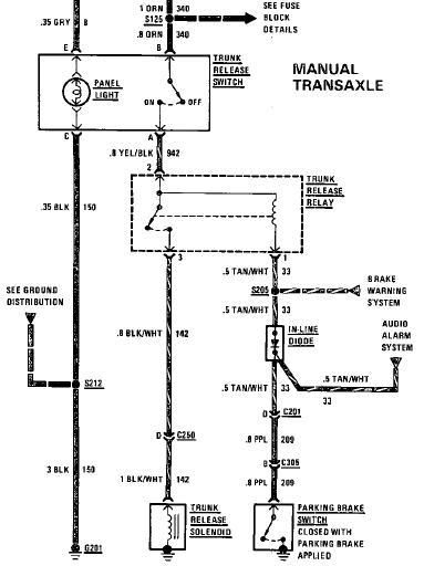

The park brake has a ground switch that grounds the trunk poper relay so you can't open the trunk while driving.
Sounds like it got tied into that curcuit. Might just need to rewire to a different point.
This is for Auto or manual so look at the e-brake line.
