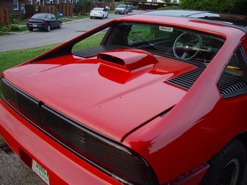

OK this is driving me nuts. Thought I had the solution. When it is in the 70's or lower does not seem to be a problem but in the 90's it's back. Starts cold just fine. Drive it for a few minutes and shut it off it hardly wants to crank. First thought was heat soak to the starter so I put a blanket around it. Next I put a rear facing hood scoop on the decklid and a passenger side side scoop that feeds fresh air to the engine compartment. Still does it. If it's not too hot I can jump it and it helps but not a great deal. Getting a rotten egg smell from the cat too. Running rich? Going back to shop on monday for rack bushing so I guess I'll have it checked then.
If it cools down outside the problem goes away pretty much. I have driven this car for a year and it has not given me as much trouble as it is at the moment with this heat issue.
Ideas? Don't want to take a long trip and get waylaid some where. It's a new crate motor, starter etc. Using a Optima battery.
