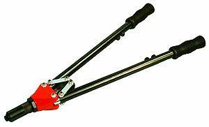

You want one of these. Takes rivets with shafts up to 1/4". In Canada, you can get them at Princess Auto (PN 804882) for about $20
You should be able to find them at other stores. I also see them on eBay

Those things are about 2 feet long, lol. There for specialized rivets like for mounting door handles. Quality tool store wanted close to $300 for one. I bought the $20 cheap one at Harbor Freight. I only use them once every few years. If id buy the expensive 'quality' one, Id just lose it before ever using it the second time anyway.
The ones for plastic rivets are slightly different the way they grip, i dont know if a reg pop rivet gun will pull them or not. If I get rivet sticking, just make sure the handle is coming all the way back open to release the stud. Sometimes cheap rivets 'spread' at the break and cause them to hang up. I keep an old hex key the proper size to push them out.

I bought one of those - I do not like it one little bit. Try to install something like a T-Top frame and you'll learn to hate it too. I've been trying to give it away but nobody seems to want it...
What DOES work good is the air powered riveter that Harbor Freight sells. Their "top of the line" model goes on sale for $50 every time a dog scratches; if it's not cheap today, check back tomorrow. It sets those 1/4 inch steeel rivets with just a pull of the trigger and it's small enough to get to all the places that rivets are located in our cars. Highly recommended.
But avoid that long-handled misery machine; it's OK for smaller stuff but you'll work up a sweat trying to set a 1/4 inch rivet with it...
