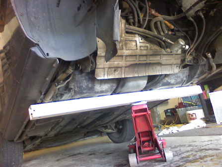

lol thats an interesting way of doing it fieros everywhere ive also seen people put the fronts on ramps and lift the rear with a hoist ever tryed that technique before and thanks those links are pretty usefull still have to find prices on a tuned chip or ecu or piggyback style something also what do you guys got tied into your swaps the swaps dont make me that nervous till i get into boost which is kind of complicated
Boosting is not complicated at all, boosting with a guestimated tune on a chip makes things complicated. The last I checked on a 4.9 more than a year ago I could get them in Florida for $300-350 all day long. The challenge comes with how much of the work you can do yourself. If you have all of the required tools you can do this swap rather easily and with minimal costs. It shouldn't take more than a cam regrind and a good exhaust to the turbo to get good performance from the 4.9 with a turbo. The 3800 is dealing with a supercharger and although they both make boost the dynamics are not exactly the same.
