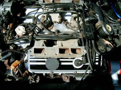

Report this Post07-13-2007 07:37 PM Click Here to See the Profile for GokartSend a Private Message to GokartDirect Link to This Post
Gokart
4635 posts
Member since May 99
Figures my luck this week.....with a %50 chance....I'm wrong Wouldn't crank over. So I'd like to do it the right way. No ghetto's! After removing the distributer do I point the rotor back at #1 or do I face the rotor where it's facing now which is #6 because I cranked it? Also, when I crank it to get to TDC do I crank it quick or does it not matter as long as I do it once?
[This message has been edited by Gokart (edited 07-13-2007).]
