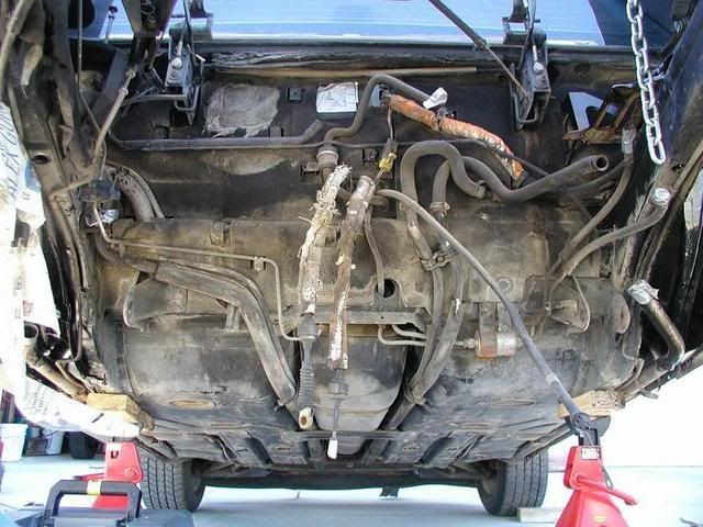

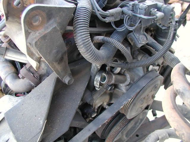

Take a look at this picture from Dodgerunner:
See the heater hose with the open end facing you? That goes to the thermostat housing.
The other hose connects to a metal line that follows the frame rail to the trunk, then up under the dogbone, then over to the water pump.

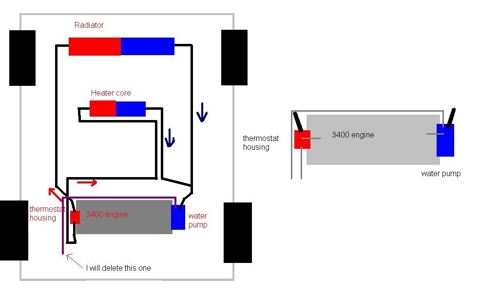

LZeppelin513
761 posts
Member since Aug 2003
So I drew up this diagram of what i think is going on, i realize that my 3400 is different than the 2.8 so included a small diagram of the 4 water lines on the engine. I am also sure that a heatercore line runs into the passanger side coolant line in the engine compartment. So guys do i have this right?
