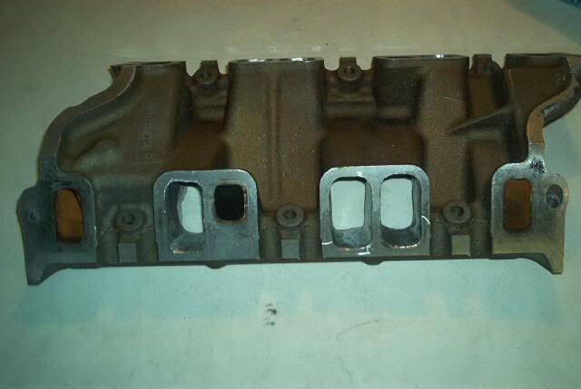

I'm also removing my intakes next week to replace my fuel injectors and valve cover gaskets. I purchased this gasket set from TFS http://www.fierostore.com/Product/Search.aspx Should we use RTV on the outside edges as well?
Originally posted by wftb:
if you read the instructions ,the rtv is to seal the ends of the lower intake where there are no gaskets .
Can someone post a pic where there is no gasket and only RTV is required please

Report this Post07-04-2007 08:36 AM Click Here to See the Profile for HudiniSend a Private Message to HudiniDirect Link to This Post
The RTV goes on the left and right "S" shaped flat surfaces in this photo:

The photo above doesn't look like anything I'm working on...

that is the underside of the bottom intake manifold .the 2.8 v6 has a three piece intake manifold .if this lower intake is not leaking(and unless your motor has been torn down , it probably isnt ) leave it alone .this is the only manifold that you need to torque down over the course of a few days . the other ones dont have crush space ,and dont need any sealant .

well, a slight correction to that. the true intake, the part that mates to the head only uses sealant on the outter edges, as was mentioned. the manual instructions cover that very well.
if you torque it properly, following the sequence in the manual, even with the std felpro aftermarket gasket set, you only need to do it once. if you need to do it again, you didn;t do it right in the first place.
the middle and upper plenums should use no sealant, and be torqued according to spec. be absolutely sure that all mating surfaces are clean!!!!!!!!!!!!!!!!!!!!!!!!!!!! that is the biggest problem I;ve seen on assembly of any intake, lack of proper cleaning.
the other side of that is someone hitting it with a sanding wheel, which is also wrong. use a good scraper. examine ti carefully while cleaning it. only remove old gasket, not the metal mating surfaces.
not to start any wars on this, but the lack of proper cleaning and torquing is the biggest issue in intake problems. and the torgue number is not nearly as important as that all are set to the same value, you don;t want to warp anything.

there is no sealant used anywhere on the upper & lower plenum. there is RTV used as the front & rear seal on the intake manifold. and, there is 2 small daps of RTV used on the valve cover seal at the point where the head & intake manifold meet on each side.
