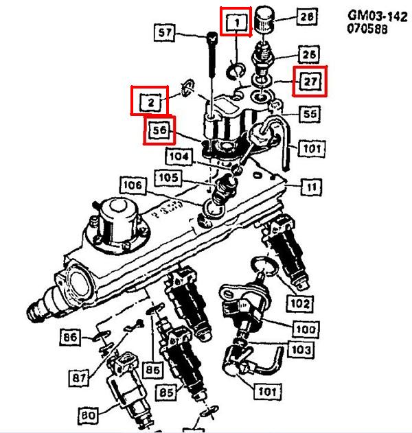

This shows the gaskets I'm talking about:
The Fiero parts manual doesn't show a separate part number for the schrader valve gasket or the fuel inlet / outlet block gasket.
They may very well be part of the entire fuel rail assembly P/N
I got new ones separately from the dealer. I just took the old parts in and the counter guy ordered me new ones. Approx. $10 if I recall.
