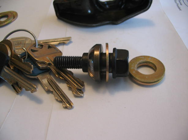

I took off the valve cover and ran the engine, listening with a stethescope, definately pushrods and rockers making alot of noise. I could hear the echo off the apartment next door LOL.
[B]Originally posted by Whuffo:[/B
Many have commented on the noisy valve train - thin covers and no valve adjustment is what causes it. If you wanted to quiet down the valve train, you'd need to find / install custom length push rods to get the valve lash right.
I was thinking about the same idea earlier today, maybe 2 MM longer pushrods on my noisy Duke. I did take the loudest rocker off and will let our shop mechanic and the auto parts store manager look at it. Maybe I've got some wear but if I can use longer push rods, why not?
What does everyone think about longer rods?

Ok, so I'm new to Duke engines, lets think outside of the box for a minute, in other words, don't laugh too loud at me for this next thought.
What if, instead of longer pushrods, just mill a fraction off the bottom of the push rod guides? That would in effect lower the entire rocker assembly that sits on top taking up any slack causing the noise. A machine shop should be able to mill a little off, isn't that called "decking"? I did not want to torque down more than 24 ft/lbs on the rocker bolts, didn't want them too tight causing friction heat and wear. The more that I was tightening the quieter it got so lets go and talk to the machine shop guys about a little custom work.
My thought is that the lifter is hydraulic like the V-6 engine and should easily be able to compensate for a little lash.
Ok, is this a dumb idea or what?

This might be the smartest dumb idea that I have had yet.
I'm trying to take up the slack in the valve, rocker, pushrods that is causing the ticking noise; right? The options are mill the head or longer pushrods or shave the pushrod guides or,,,,,,,,
,,,,,ready,,,,,?
,,,,,, simply use a washer under the rocker bolt head.
A thin hardened washer under the rocker bolt head would lower the rocker and easily take up any slack that wear has caused over the years. Correct me if I'm wrong but since we're dealing with hydraulic lifters; this is like resetting the valve lash so to speak.
Man alive, I want to try this out but I'm stuck at work!

Originally posted by 2.5:
Jetman, let me know how that goes! What year is yours? Mine is 86.
I got real nervous when the engine didn't immediately start knowing that we are on uncharted waters so I stopped and pulled the washers out. In theory should be ok if I had washers that were only 1/4 as thick as the ones that you see in the picture. Turns out that the car was a bit flooded but nevertheless, I decided not to proceede any further and went back with stock configuration.
You know that it would be nice to find an inexpensive quick fix, especially for us appartment dwellers that aren't supposed to do "repairs" on their vehicles in the parking lot. A quick fix would be temporary until I could perform proper repairs, the engine runs strong, just noisey. I would love to go ahead and freshen up the upper end, just have to wait, to many other projects going on.

I like the washer idea, and know the lifters "should" adjust.
BUT, if the washers are too thick they may not let the valves close completly at higher RPM. shouldn't happen, but could and that would be bad.
Can we find out what the stock clearance between the rocker and valve on a 87-87 duke? Maybe someone with a low mileage or rebuild could check with a feeler gauge.
Then the washers could be sized correctly to match stock clearances.

Something don't sound right with the washer test. If you torque the bolt to 24 lbs/ft then everything will still be the same as before. The difference is the bolt is just not as far down into the head. Am I off in my thinking?
