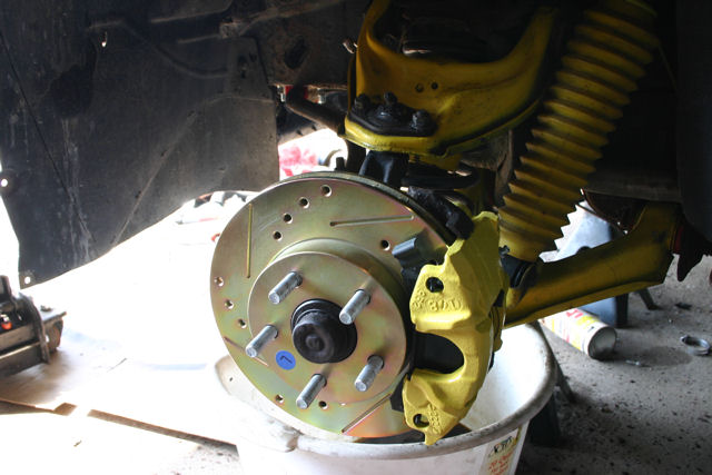

Brake hoses had complete slices where they connected to the brake line.
Brakes feel weak, no matter how hard you press on brakes they wouldn’t produce more stopping power. (from lines expanding)

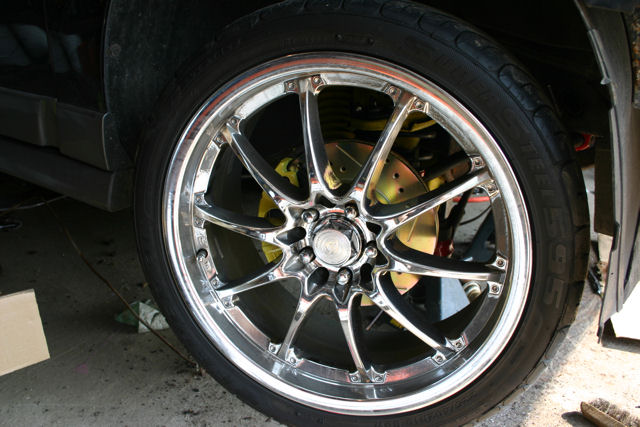

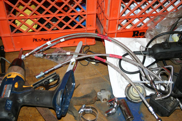

I Ordered and bought all Stainless Steel brake lines and Stainless steel braded lines from the Fiero store. I ordered Vented Drilled Gold Zink coated Rotors from Ebay and bought 4 new Beretta Calipers at Advance Auto Parts.

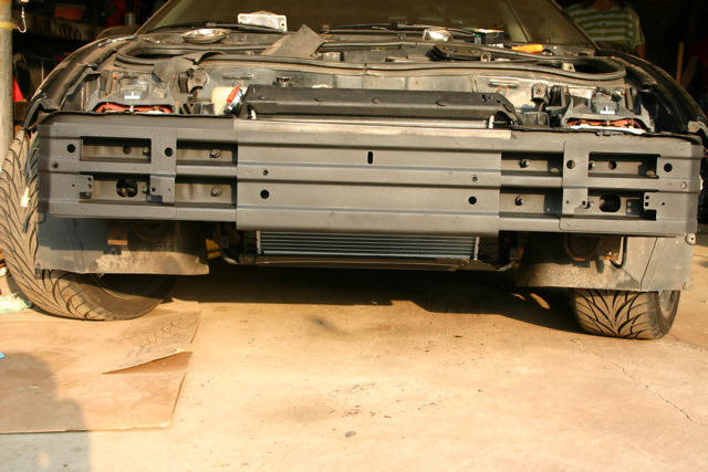

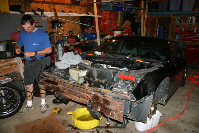

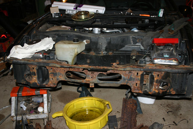

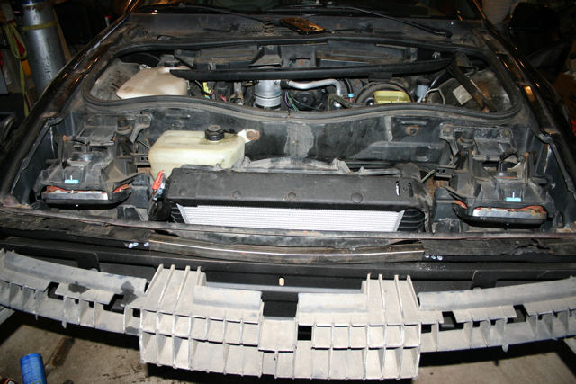

But when I was up under the front I noticed a few things one of the biggest is that my Radiator was just floating in the air, the entire lower core support was rotted out, and when I looked under the front bumper I noticed that the bumper support had fallen down and that the metal bumper was rotted.
This is what I found
It looks like it was hit kind of hard in the front end but every body part has the correct VIN, I just find it hard that you can get the front bumper to bend but not hurt the front clip.
So I posted that I needed some parts and MstangsBware answered. Within a week I received the parts, and they where exactly what I needed, I cutout the center as it was rotted and put in a 1” square stock to give support for the upper fascia. I also decided that I wanted a newer improved radiator, as the original had to go and the loss of 4lbs from it to .

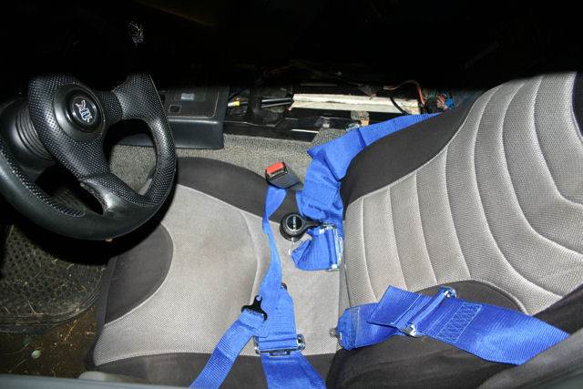

I also decided that I wanted to take my safety a little more seriously so I ordered 6point harnesses, I seen where others have complained that the Fiero seat is to wide and I do agree with this but I have gotten them comfortable and also left in the original seat belts also. I used both the original mounting points for the seatbelts this holds both the sub belt and the side belts as they are M12 Bolts using some spacers and mounted them down there, the upper straps I drilled a hole directly in the lower center of the Hood Support and put a washer here, this makes the two shoulder straps come out and go around the seat then back down this way it tightens around the seat and over your shoulders I find them very comfortable this way and with them tight I can not get out of them, it’s a whole new experience with these on, its just like a roller coaster ride.

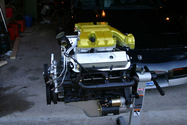

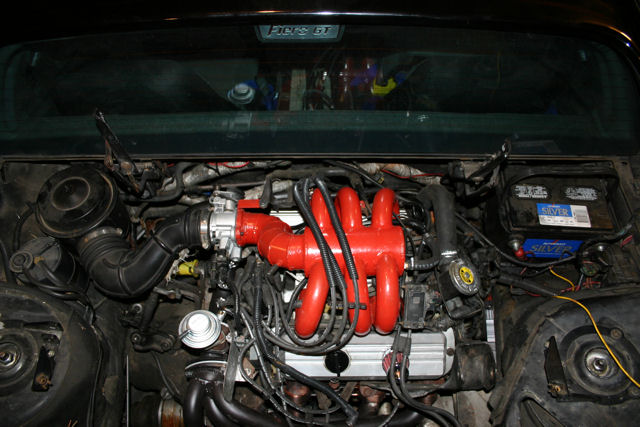

So knowing about Trueleo and the work those guys had been doing, and seeing the truth in there Dyno numbers I decided to buy there Custom Headers knowing that the stock exhaust system on the 2.8 was a large issue let alone on the 3.4. Later they contacted me on one of there Prototype long runners they still had and offered me a great deal on it also, so I took it also, with a new intake and exhaust I knew that the motor would get all the air it needs, I also ordered a new Big bore TB off of Stick47 on Ebay, I was very pleased with how well it was modified.

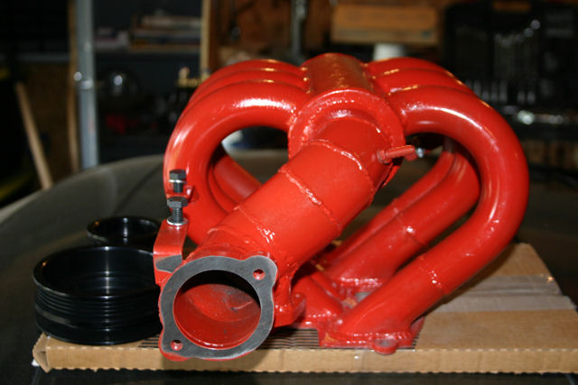

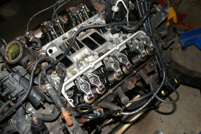

I looked into upgrading my Cam as we all know how much we love the 2030, I have this cam because when I bought a cam for my first Fiero 10 years ago there wasn’t another cam really on the market. I liked the idea of the new cam but decided I didn’t want to do that much work taking everything all apart again, and replacing the springs etc. so I opted to just put in 1.6 roller rockers for now, maybe next year, though I think I will just try to sell this motor and go for a 3.8SC next year. (more Power)

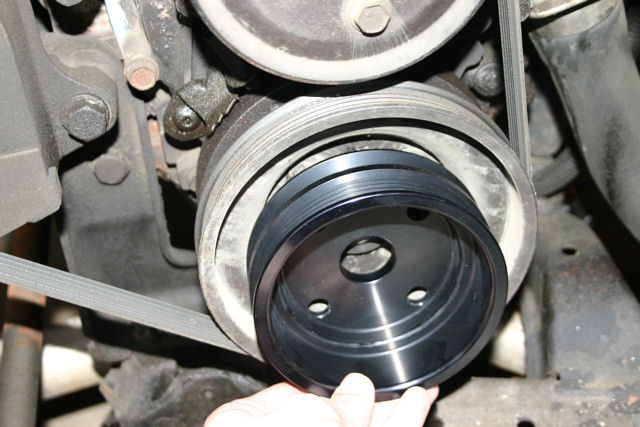

The under drive pulleys what to say about those, there is a large difference and I had some issues after the first test drive or two, it looked like the car was over heating I have a digital summit gauge installed in the car * I destroyed my first Fiero motor from a failed water pump and no working temperature gauge * I also didn’t like how the car would run at lower RPM because of the alternator I still had the old original SI unit, so I installed a brand new CS 105 alternator but at the same time thinking that I was overheating now, I put back the original Crank pulley, little did I know I was still overheating by the gauge but I had installed a 205 fan switch and it wouldn’t be on but the gauge would read 260deg. When I connected winALDL the computer thought the temp was 190deg. This turned out to be because of a Grounding issue with the gauge. Run the ground for the gauge directly to the engine block as it uses the ground that it receive as the baseline for the resistance in the sending unit (if your gauge changes because you step on the brake or turn on lights etc. then this is your problem)
Now it’s nice and steady.
I will have to put the under drive pulleys back on and try out how everything works now that I have the new alternator and the fixed gauge.

I also ordered a set of 96 + fuel injectors for Mustangs, off Ebay, this set of 8 19lb injectors use the 4 hole style for more efficient spray pattern and with a 12-13 resistance they seem to be working great and only cost $50.

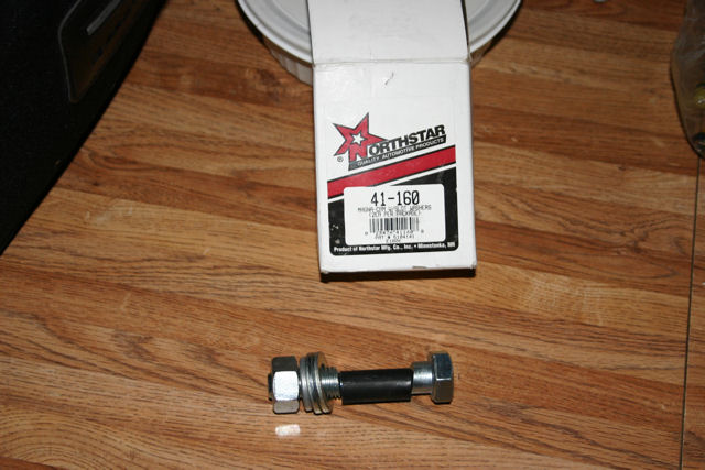

Along this line I also put in a camber adjusting bolt for the upper part of the strut when you lower the car 1” the adjustment for camber is just at the edge of factory adjustments, this gives about.5 to 1degree more, and can be bought from Advance Auto Parts *though take the number you see on the box as most salesmen wont know what your talking about.

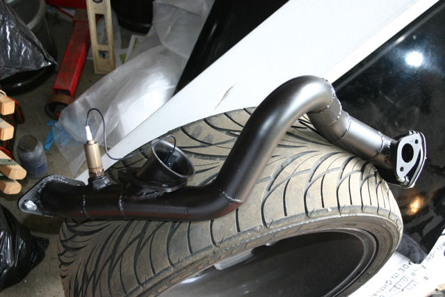

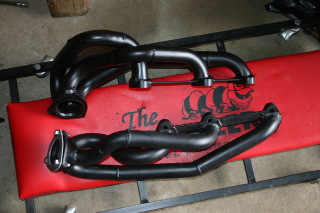

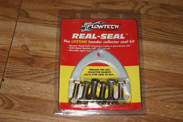

Also for Trueleo's exhaust i wanted to make sure i had not leaks and did not like the fabric gaskets so i bought aluminum ones that seal better and are reusable.

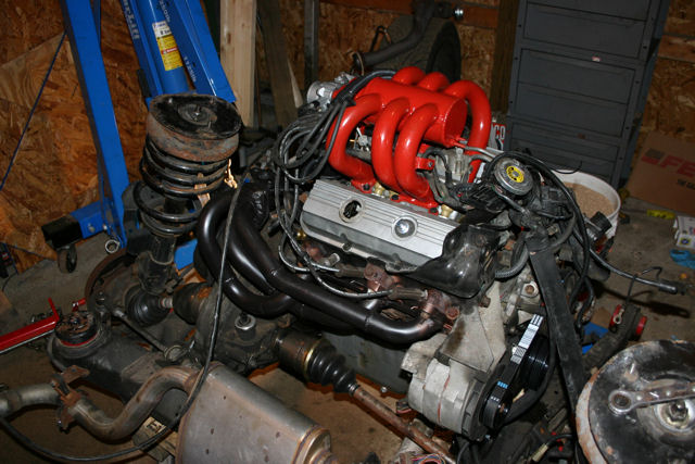

engine pictures

How it feels now, first off I am happy I installed the Harness lets start with that. The brakes, anyone that says they require going to larger brakes, you don’t, the GA brakes may not look large under my rims but I will post stopping distances on them shortly but I can pin you to the seatbelts from 70 and stop within seconds with them, I am using ceramic pads and did change the master cylinder to the smaller bore. Yah it takes a little farther down on the pedal now but I have a wider range of control because of it.
