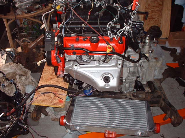

This is what I bought for my project which will be augmented with the injection kit I linked to above.
http://cgi.ebay.com/ebaymot...em&item=250124900100
There's room in the back, however I still have to re-explore the possibility of a front mount with plumbing hidden inside the rocker panel spoilers, clearing the front cross member without getting to close to the road is the key.

For a 3800, A/W IC is the best way to go with the stock m90. Will it work better for a turbo setup? Maybe, GN guys seem to dabble with it, with some real results.
My 2nd car, im glad I got it IC'd... ran 2.7" all summer long with cam and headers, stock catback with no issues.
