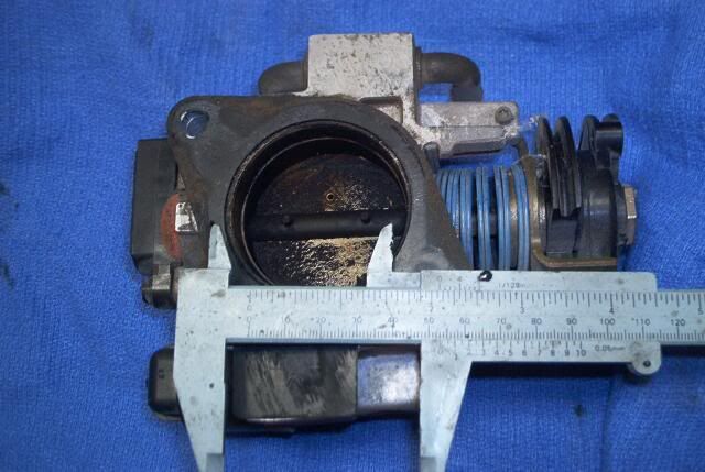

Surprised me too when I heard it so I measured, sure enough:
(It moved to 53mm when I set it down, but it was 52mm)
[This message has been edited by Hudini (edited 06-11-2007).]
