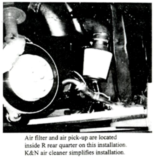

Works for me. Old photo showing K&N location, but only one I have.
Filter sets right in pocket just behind pass side air inlet. You can service it from the bottom after jacking up right side.

Cali Kid setup is basically the only thing or easiest to do. I had that but when I upgraded to a slightly larger filter it didn't fit (my water pump is in there too) so I have to redesign it again.
