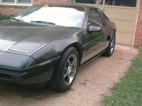

<HIJACK ALERT> Hi, your car looks a bit like mine!

They do look similar but I belive you have a V6 and I'm still using the Duke :-(
