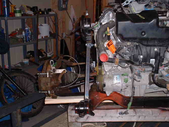

i paid 1000.00 cdn plus tax for all this:2.2 eco and 5speed tranny intact with all wiring and clutch hydraulics mounted and funtional
air filter ,intake and airbox mounted on throttle body
entire car 2004 cavalier wiring harness (front to back ,everything)
steering collum with key in ignition
cavalier shifter and cables
one cavalier axle
later i bought and added to the car :cavalier fuel pump ,cavalier instrument cluster cost 195.00 for both.
now i am turbocharging the car .a lot of trial and error but i am avoiding big buck store bought kits and i am close to where i want to be (200 rw hp)with driveability.
the AC just requires a notch on the hooped section of the front crossmember not load bearing on my car but if you use mounts in the stock position you should box it after the cut.
