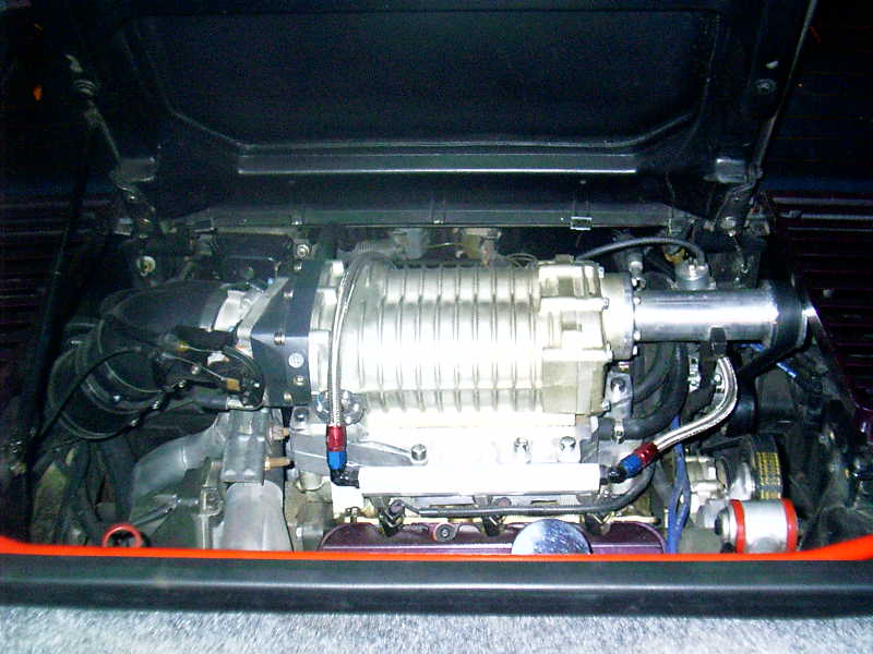

Ya'll can "think" all you want
This thing kicks a$$

Revin, can you give some details on those fuel rails? Build thread or anything, really.

i dont know squat about superchargers .what is an m112 and why do the two superchargers look different if they are supposed to be the same .thanks

Revin, thats not fair, its not a REAL 112..

That is an m112 hybrid, which is a gen3 m90 casing with rotors out of an m112. I would consider that slightly better then a gen5. To capitalize on any serious gains from that over a M90 you will need heads and a big cam. Running it with stock heads and cam, the motor can't flow the air it can move (which will dwarf the gains from having a bigger blower).
What are your other mods besides an intercooled m112 hybrid?
What are your 1/4 mile times?
How much boost are you running?
ok.....
a 97 3.8 series 2, boerd 30 over Diamond forged pistons, VS cam, light modded heads, TOG headers, homebuilt IC, Eaton ZZP M112 Hybird blower (18 lbs boost) LS 1 TB, SLP Maff, ZZP ICCU, Intense stage 1 LSD, 3.29 gears, rest of tranny stock.
personal best of 11.97, 60 ft was 1.77 , trap of 114 MPH.
