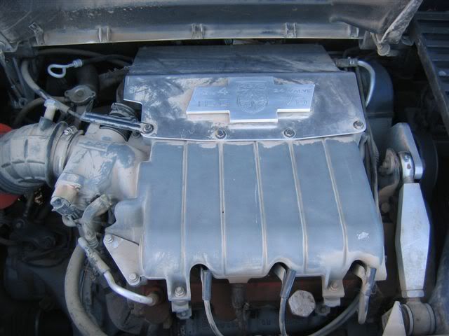

Here is a solution, an aluminum hood with a decorative monogrammed bow tie
