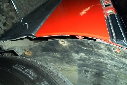

Make sure you have the gt cartons and you should be fine. If you don't have the wheel well extenders your wheel wells will have an open space in them. If photobucket starts working again I'll post a pic
here

I just changed mine out today orginally an "86" coupe front, installed a GT front Fascia make sure you have the rubber shock absorber they are different also the front inner fender well's are different, and make sure you have the front blinker lenzes brackets the origanal blinkers lenzes will fit into them.

The wheel wells are going to be different also, try to grab them from the donor car. You might be able to get a way with the ones you have, but it might result in some cutting and possibly some empty spaces.
