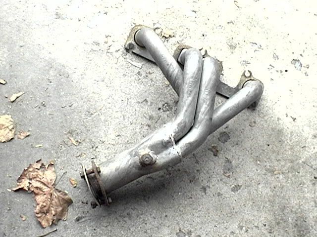

I have an old performance header from 3 years ago that I had on my Duke. I brought it from the fierostore for $250. I don't believe they make it anymore. If your interested I will sell it to you for $100 plus the shiiping. Its was only used for 6 months then taken off for the Turbo Duke I was building. I think some of the powder coating has come off but still good. It will make a slight diffrence not much though. I will try to get some pics for you today when I get home.

I too have a Fiero store header on my duke. Bolted up nice and looks pretty, but I don't think that it made much of a difference. The only reason I bought it was that I got it really cheap on ebay. It might make a bigger difference on a higher hp duke though.

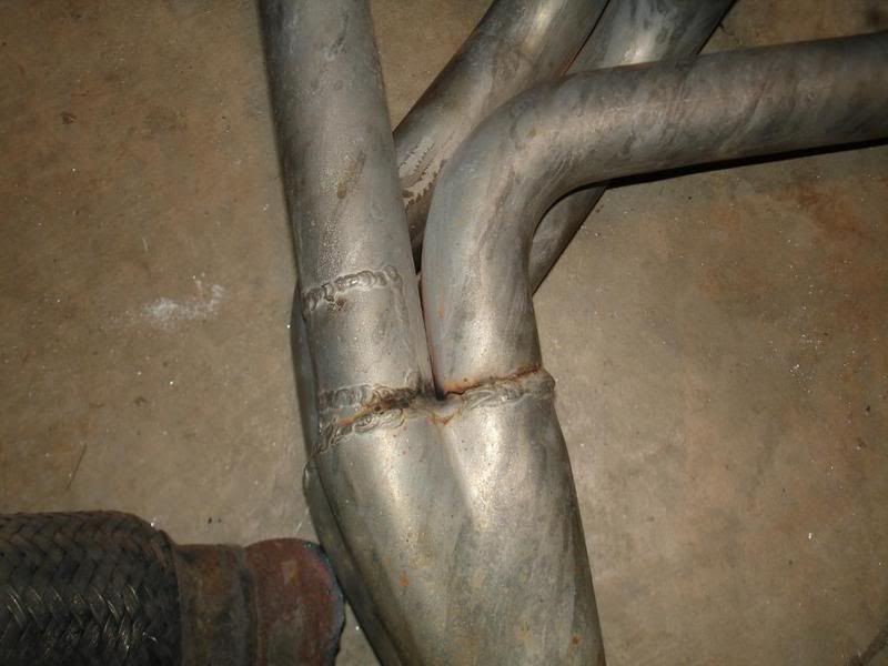

Hooker Headers sold a performance header for the 84 Fiero (works with other years as well). It was a really nice piece. I remember that when I first got into this hobby 10 years ago, you could STILL buy it both from them, and the Fiero Store. I still have the Fiero store catalog from 1997, and it shows it in there. It was something like $219 bucks. It included the header, as well as a complete header pipe (the piece that goes from the header, to the drivers side, does a 180, and heads back around to the cat. If ANYONE runs into one of those on eBay, SNAP IT UP!!!
They stopped making them, but it was THE best bang for the buck for the Iron Duke.

According to the Super Duty Guide, Hooker made 2 styles of headers. I found some pictures.
PN 4703 is the Tri-Y design that wraps around to connect with the catalytic convertor.
PN 4702 is the 4-into-1 competition style that was used on the Indy pace car without convertor.

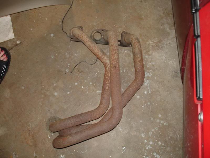

Report this Post01-25-2007 05:44 PM Click Here to See the Profile for fst4rscSend a Private Message to fst4rscDirect Link to This Post
Thats my engine. That header is well built. I paid extra for the ceramic metallic coating and it still looks nice. Im wondering if hooker would still build it for you. You could try to get someone at JEGs to special order it for you?
BTW this engine has Crane roller rockers, a mild Amotion roller cam, and a Holly big bore tbi. It was ported, indexed, and balanced, and is producing somewhere about 120/130 HP with stock electronics.

Just found this. Anyway, I own an Indy that has the Hooker Super comp headers mounted. They make the duke grumble nicely and I can feel the difference from my last duke, it's not alot, but it's there for sure.

forgot there was a set of duke headers on the mall about 2 weeks ago they were rusty looking, so there is a small chance they may still be there no header for a duke is going to be cheap,because of rarity
