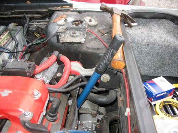

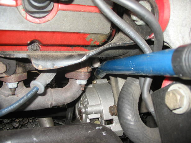

Here is my one-man alternator tightening trick for you. I use my jack handle as a lever against the engine brackets and alternator then since I left my wooden wedge at work I wedged a hammer handle to apply tension.
See how I have the handle in there?
I wedged in my hammer against the trunk wall to apply tension.
My belt don't squeel.
