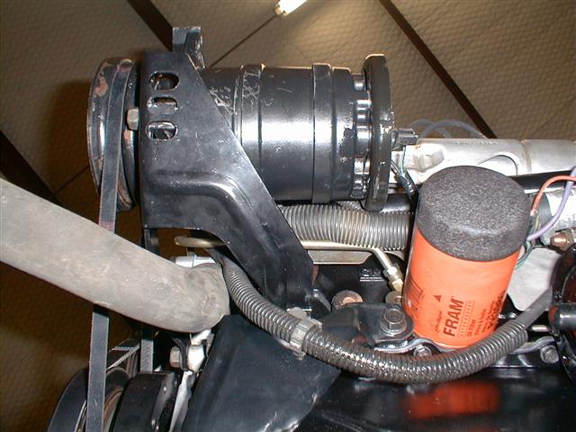

while we're on the subject, could you guys tell me how to change the separate A/C belt (86 2.8) i bought the belt because the one on there is freyed a little and it makes me nervous (dunno why, it's not like the alternator belt)
we couldn't figure out how to get to the brackets to loosen the A/C. there's one bolt on the top and like 2 on the bottom?

Report this Post04-09-2007 06:38 PM Click Here to See the Profile for Richjk21Send a Private Message to Richjk21Direct Link to This Post
Okay, I'll pass along a method I read on here ... I have not used it before, so make no guarentees, but it sounded pretty reasonable to me. First there are like 2 mounting bolts for the top bracket, they are basically inboard and outboard, they are the pivot points for the compressor. Then there is the one bolt at the bottom bracket, this is the one that moves in the slot to adjust your tension. The method I read said don't mess with the upper bolts, but loosen the bottom bolt, then you can use the cutouts in the bottom bracket (see pic below - Couresy Jazzman) as a lever point to move the compressor and apply tension while tightening the bolt. This pic is looking up at the lower A/C bracket from below (think laying on your back under the car). Like I said feel free to give this a try .... if it doesn't work you can always still loosen the top bolts, but they're a real bear to get at .
Rich

Like stated above, you don't need nor want to loosen the top bolts. Just the lower one and then you can tighten the belt to the A/C.

Report this Post04-10-2007 03:34 PM Click Here to See the Profile for DodgerunnerClick Here to visit Dodgerunner's HomePageSend a Private Message to DodgerunnerDirect Link to This Post
You also have to remove the serp. belt to be able to change the AC belt since it sets behind the serp belt on the crank pulley.
So have to loosen two belts.
