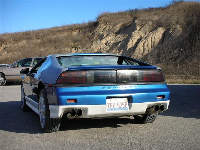

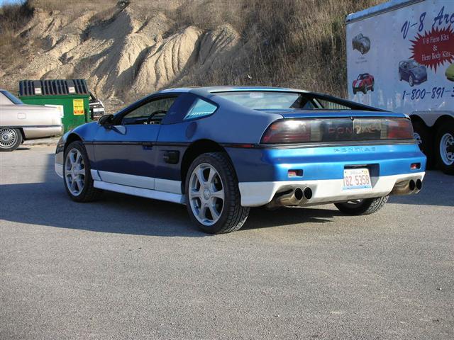

Well I first wanted to thank all the people who have made theads on projects they have going . I did not show pics of installing the dash because others have and what they have done works for me . I also would like to say I have never played with fiberglass until now and I am sure it shows in my work . The good news is that I plan on covering the the center console with a thin foam and some kind of material. The dash is from a 93 mitsubishi.
I have all the vents working except I didnt run the duct work for the side windows defoggers and the little one below the steering wheel . I dont plan on making these work as its a small compartment and have no plans of winter driving. The mounting bracket in the glove compartment area is only temporary. I am still deciding the best way to mount that .
I am looking for any ideas or comments that you guys might have on anything that I am doing.
My plans also for the car is to fill in the holes for the rear spoiler and to mount the antenna under the fender and fill that hole also. I also would like to get black carpeting for the interior, the headlight buckets that Fiero1Fan is offering a couple of body mods and then sand and prep for paint. Chris
