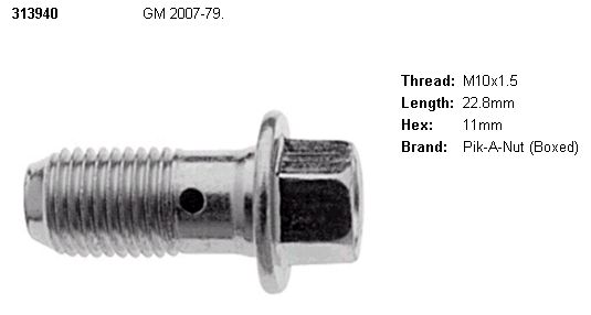

You were clear, I just misread. The parts book says it's a bolt, brk hose (M10 x 1.5) p/n 14094948.

Dorman/Motormite also has them:

Quick note: Torque specs:
Front brake hose to caliper bolt.
1984-85 == 39lbs
1986-87 == 30lbs
Rear brake hose to caliper bolt.
1984-85 == 39lbs
1986-87 == 15lbs
Front and rear brake hose to caliper bolt
1988 == == 33lbs
Also check the new insert note that Cardone Brand have been slipping in to their calipers, its alot lower.
