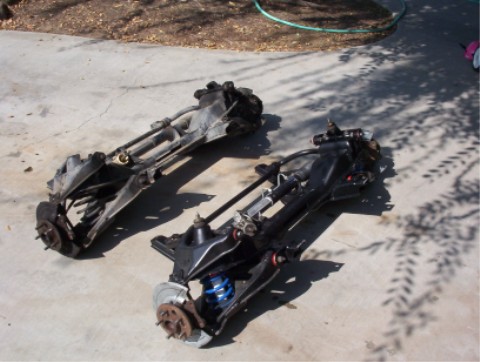

mcaanda
Posts: 3652
From: Grand Junction Colorado
Feedback score:    (19)
Total ratings: 129
Report this Post11-23-2006 10:50 AM Click Here to See the Profile for mcaandaSend a Private Message to mcaandaDirect Link to This Post
Originally posted by F-I-E-R-O:
This is cheaper...
But this is better:
2ooo TA PS Rack; the one w/ the colored goodies on it:
--Allen
