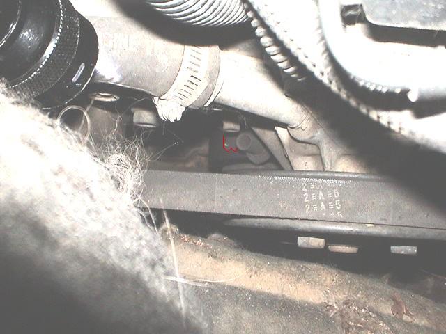

  where is the 10' timing mark on the V6
where is the 10' timing mark on the V6 by buddycraigg

i cant read any numbers on the tab.

Buddy - I have this pic if it helps. Each line is 2* and the markings are stamped every other one, I.E. 0-4-8-12. The unmarked lines are 2-6-10. My pic shows the crank at almost zero and the paint mark on the tab is 10*. Hope it helps.

Tell me something. That tube by the timing tab is used for what.
Don
buddycraigg
Posts: 13620
From: kansas city, mo
Total ratings: 478
Report this Post11-20-2006 08:07 PM Click Here to See the Profile for buddycraiggSend a Private Message to buddycraiggDirect Link to This Post
that was some silly special GM tool that fit in that hole.
i think it was magnetic and would trigger when the groove in the ballancer would go by
most shops stopped using them in the 70's. i dont know why GM kept putting them on there
Some modern equipment still use the magnetic pick up today. It is used for checking ignition timing and reading engine RPM.
Many dyno machines still use it for reading accuarate RPM's mainly on cars without ECM.s. It's not just a "GM thing" Ford and Mopar had them as well.

Dodgerunner
Posts: 9687
From: Lincoln, Nebraska
Registered: Sep 2004
Feedback score:    (61)
Total ratings: 323
Report this Post11-20-2006 10:14 PM Click Here to See the Profile for DodgerunnerClick Here to visit Dodgerunner's HomePageSend a Private Message to DodgerunnerDirect Link to This Post
Just another angle
