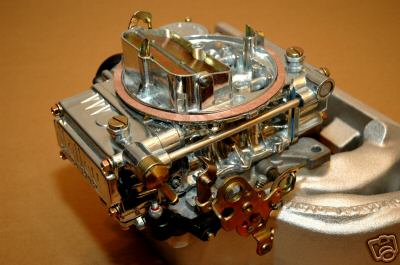

Brand new Holley on ebay ideal for someone wanting to convert their V6 to carb. I need an Edelbrock instead. Canadian buyers, keep in mind you won't be stuck paying PST, GST and "brokerage fees" (already did that).
http://cgi.ebay.com/ebaymotors/ws/eBayISAPI.dll?ViewItem&ih=008&sspagename=STRK%3AMESE%3AIT&viewitem=&item=180052178413&rd=1 ,1
