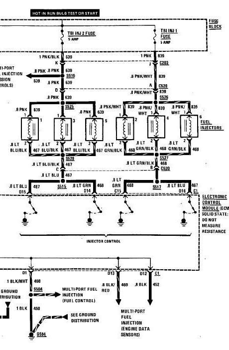

Have you ever check the pink and pink/white wires to see if they have power on them at the injector harness?
If they don't have +12 then the noid light is probably not going to do anything.

Excellent advice. If the noid doesn't flash during cranking, check for 12V. The 12V is supplied from the fuse box, and the ECM grounds the injectors to complete the circuit and "fire" the injector.

I am getting +12 on the pink/white and I am getting +12 on both terminals of the fuel injector...one side should be grounded right???I am doing this with the key in the on position... does that mean my I have a short somewhere

If the ecm is not firing the injector you will read +12 on either side of the inj. to ground.
You should see a lower voltage on the one side when cranking since the ecm should be grounding it.
Since it is a fast pulse you will not see to low a voltage but might see some drop.
If you put your meter on low AC volts you would probably see a small voltage while cranking if it is pulsing. Not certain on that but in theory you should.

ok, you determined there is 12v there, so you don;t have a short.
connect the noid light and have someone crank the motor, keep th light in your cupped hand. some can be hard to see in bright light. realise the pulse to ground is only about 20 milliseconds, so that;s not much of a flash!
with a meter in a/c on the 12v scale, you should see an initial voltage spike when you connect it, then it will settle down to some reading, depending on the meter and it;s wiring how it will read dc voltage on ac scales. crank the motor. you should see the needle blip. a digital meter is not going to work for this. if it only barely reads any voltage in ac, you can go to a lower scale, ie on the 12v scale, it reads less voltage then the next lower scale, drop to the lower scale. the meter will be more sensative to voltage changes that way.
only ohter thing you could try, if you have an extra injector, plug that one in, you will feel the click when it is firing.
Remember, it will only fire if the motor is cranking, the ecm triggers off the pulses from the distributor.

So I finally realized that I needed to have someone to crank the engine in order for the noid light to work... Duh!!!! I forgot to read that detail from you guys If I wasn't so excited that I was able to purchase a noid light, I probably would've read the directions more carefully. Come to think of it, now I understand that the injectors on both terminals were getting positive voltage because the ECU grounds one side in order to pulsate the injectors. It requires less current to ground a circuit rather than send a positive 12V at that speed. So after the little mishap, I got to work doing it correctly WITH someone cranking it. The light was flashing so that indicated that the ECU was working correctly and that the problem lies within the fuel injectors/fuel system.
I proceeded to change out the fuel rail and fuel injectors to the stock '88 but still no start! I'm not sure exactly what happened but the fuel pump wasn't working anymore If it wasn't one problem, it was another!! I began to trace out the problem, read the fuel system schematic and tested the fuel pump by a power source to the G-terminal to the ADL and the pump didn't work. I traced it back to the fuse and switched it out even though it looked good.... and BAM the pump was back on again! I proceeded to crank the engine over and still no start but it ran slightly longer so that gave me hope. I then remembered reading a post that said something about idle air control needing to be working in order for it to control the fuel injectors or something like that. So I checked out the sensor and it was fully extended out. I then resetted it by turning it back to the correct length. I cranked over the engine and it started over and ran very rough and shut off minutes later. The good thing is that its running minutes now not just seconds I had to actuate the throttle in order for the engine to stay on and the computer began to adjust itself.
So now its finally running!!! (sort of... lol) I know that the stock injectors are undersized for the engine but I just needed to test the camaro fuel injectors to see what was going on with them. What do you think... Can I still run with the stock injectors or will I be running lean and overheat? Is there anything else that I should check or do? The oil pressure is high and feels as if the engine is nice and tight. I know soon with a little more advice, I will get my car tuned and back on the road. Thanks to everyone who has helped me!!! I couldn't have done it without you guys! Thank you again!
