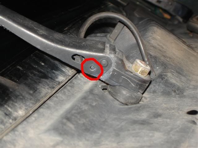

From the school of: "A picture is worth 1000 words", here's an example of what I was talking about. (Please note that this wiper arm is held on by the nut as seen in the pics, but I'm showing them as an example of the hole you should be looking for).
Here you can see the hole circled in the pic.

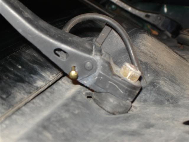

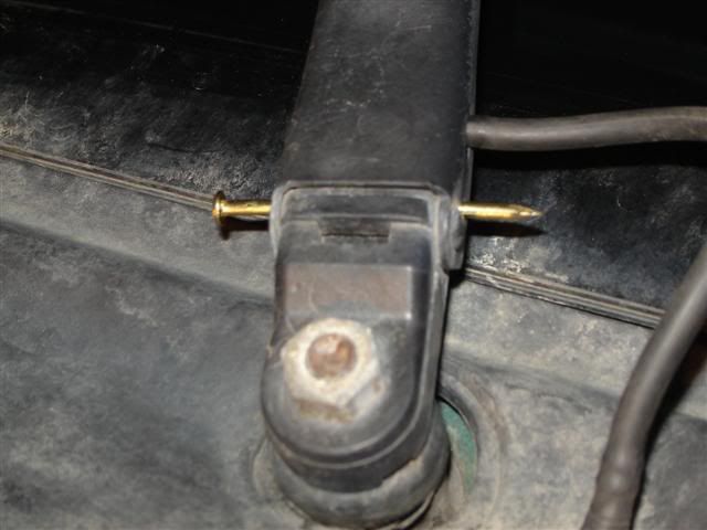

Here's the arm in the raised position, with a nail poked through the holes.
Once the nail is through the holes, the arm should wiggle free from the car. (Once again, never mind the nut; as this is a newer setup, but your's will not have this nut).
