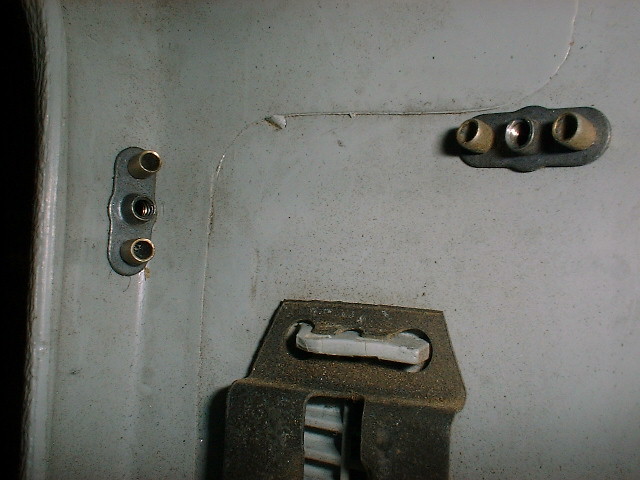

Okay everyone, here are some pics.
This is a pic of the aircraft style "nut plates" that I used so the pod can be removed without having to remove the A pilar interior trim.

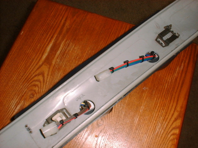

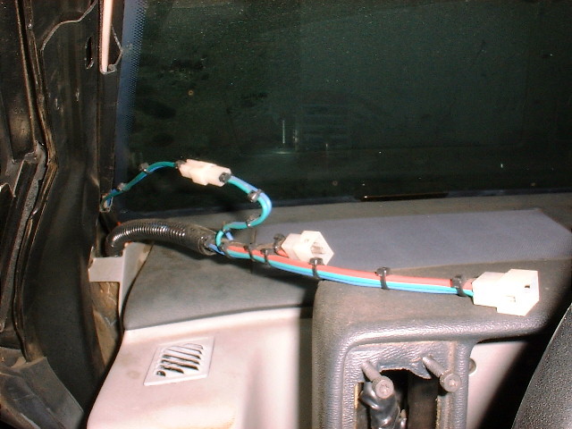

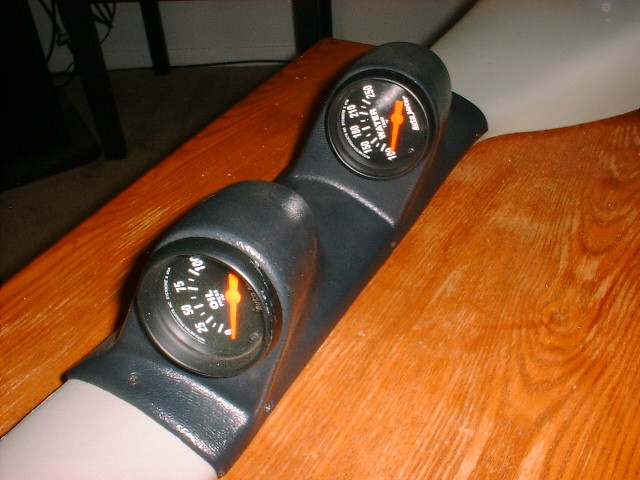

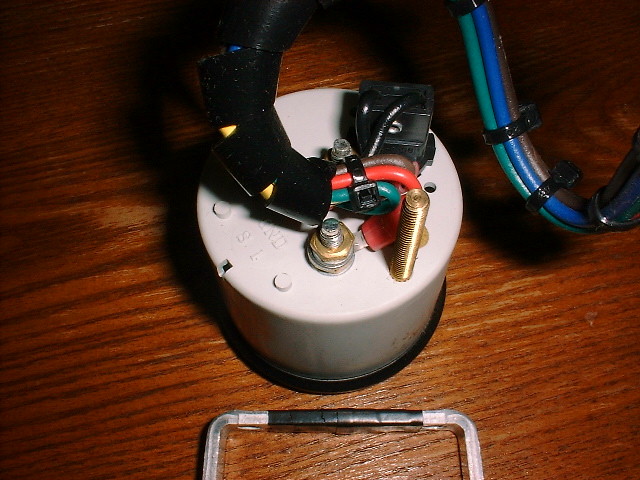

Continued.
This one shows the wiring I did for the gauge itself. I used spiral wrap on the wires so they wont chaf on the hold down bracket. I also put electrical tap on the bracket for a little extra protection.
This is the vehical side of the harness. I used to rewire Military and civilian aircraft. I make the wiring as modular as possible for ease or repair. It requires extra effort but will pay off if I ever need to repair somthing.
The connector (Molex 2 circuit) contain the sender wires. I have water andoil pressure gauges in my pod. I did not trust my factory oil press gauge. I installed all of this in 96-97. Never had any issues.
