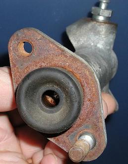

Well we attempted the bleed tonight. Air kept getting into the line
The car had a new "style 2" master cylinder on it. Finally in desperation pulled the slave off and removed the boot.
The slave was leaking around the cylinder, not much but it must have been sucking air too
Gonna get a rebuild kit for the slave and try again.
