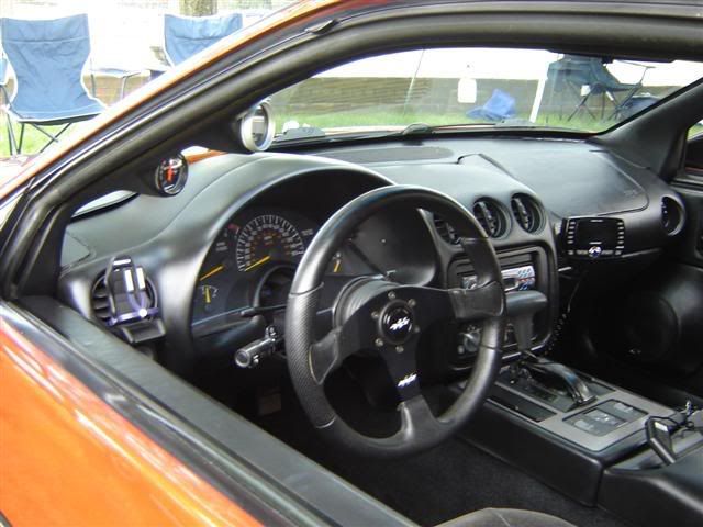

In my opinion, the best bang for your buck is the Firebird dash. With a little trimming and ingenuity you can have a modern dash for a few hundred dollars. I believe PBJ did this one in a weekend or so.

The Firebird 4th gen dash was basically unchanged from 93 to 2002. There was a mid gen switchover in 97 but the only minor difference was that the area by the defroster vent makes a smooth curve versus coming to a point.
For the gauges you definitely want the 93 - 97 though. The 98 is questionable and 99-2002 forget it, they don't work. Check out this thread for more information:
https://www.fiero.nl/forum/Forum1/HTML/023174-4.html

The f-bird dash does come out nice and does look like one of todays cars, which in my opion means it looks like all the rest of them. Most dashes today look so simular they just blur your mind when you try to remember what one looked like. Oh, and near all are some shade gray, very dark to medium. Problem with the Fiero dash and inteior I think has more to do with the common gray on grey sceam than anything. If you look at some of the basically stock insides done in other colors they look real good. And dont be fooled into thinking it's easy to change dashes. For some yes, but if you havent done any custom work, it's not all that easy and one wrong cut and youre buying another! Now I forget which year it was, but the Lotus Espree dash was quite simular to the Fiero's. Good luck with whatever way you decide to go
