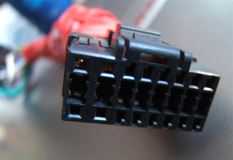

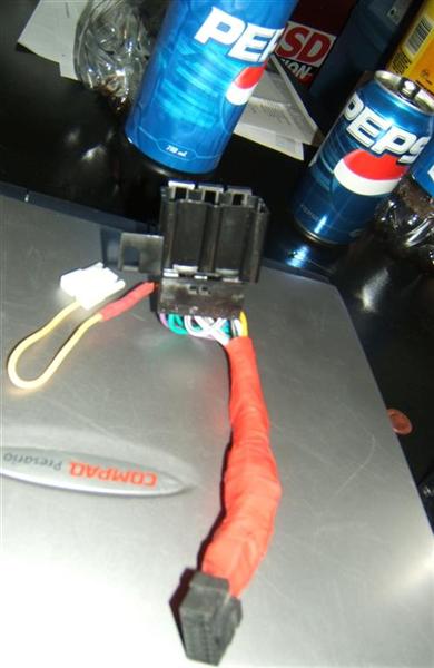

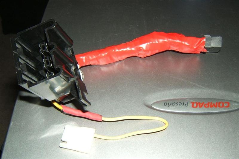

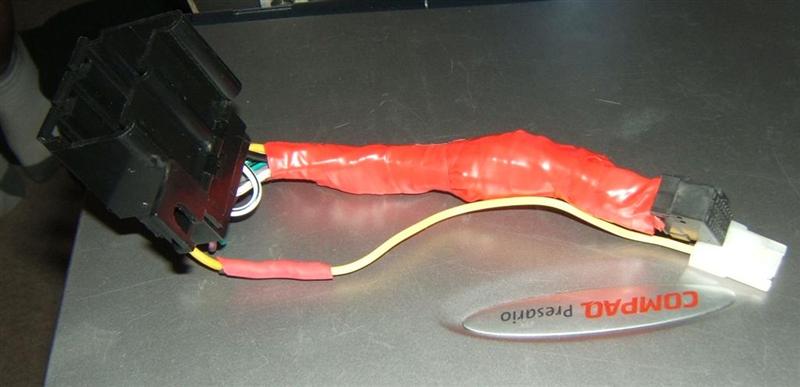

Ok I am car stereo guy back from the day when my first car had an 8 Track in it. Over the years I have seen different ways of doing things, and have done them from everything from twisting the wires and putting black tape on them, to more recently using butt connectors on everything. However seeing that no matter what I do, it always ends up after a year or 2 that I start getting intermittent shorts, speakers cutting out, stereo's that cut out on bumps I decided to do it "Right" and solid.
I grabbed the harness from the deck, chopped and cleaned up all the wires. I went out and bought a proper OE GM adapter harness. I sat down and went to town on it.
Each wire got a length of heat shrink slid over it, then an AT&T style twist, then soldered, then shrink wrap heated around the solder joint. Then taped over the shrink tube, then carefully everything after about 4 layers of insulation got bundled and tapped off.
This bugger should never short out or come apart. If it does I will toss my hands in the air and take it to a pro to have them install it. This is going into a car that won't see an amp or anything, probably will just stay with the stock speakers. But the car had a tape deck that was on the fritz.
It may be overkill, but shorts be damned it should hold up.

I just had my stereo out to replace the consel skeleton and did pretty much the same thing as you minus the shrink wrap. I didnt wanna go to overboard

Every harness I make is idential to that one.
There is alot of power running through these suckers, and it is also sensitive to interferance. I did one with butt/crimp connectors, but only because that was all I had in my car when I went over there. He hasnt had problems, but it took just as long as my soldered ones, I think the quality will lack in the longrun though.
Good work not crapping one together with electral tape!

For decades all I ever did was twist the wires and put cheap black tape over them. By the time the joints start failing that technology is obsolete anyway.
Nowadays I solder, and heatshrink, but your harness is massive. It's nice though. I would find myself wanting to add something soon and then have to cut into that harness after a year or two.

I don't plan on ever cutting up the harness. It will stay with the deck. New OEM ends are $10 or less and with every deck I buy it will get setup to work on the Fiero harness. Having a 4 Fiero family and a 5th maybe soon. I don't think I will run out of cars to install them into.

Wow, talk about overkill
The only problem with that now is that when the deck install gets "tight" that harness will not want to bend at all to fit in the dash....

Capt Fiero
7658 posts
Member since Feb 2000
Actully I did not even have to knock out that stupid metal brace. The harness is stiff but bendable. So I just tweaked it exactly the way I wanted and everything just slid into place. I was amazed at how much room there was back there when you did not have a snarl of wires running every which way.

Where's the 2nd wire in the white connector?
Capt Fiero
Posts: 7658
Registered: Feb 2000
Total ratings: 260
Report this Post09-21-2006 12:56 PM Click Here to See the Profile for Capt FieroClick Here to visit Capt Fiero's HomePageSend a Private Message to Capt FieroDirect Link to This Post
Its not used on this setup.
