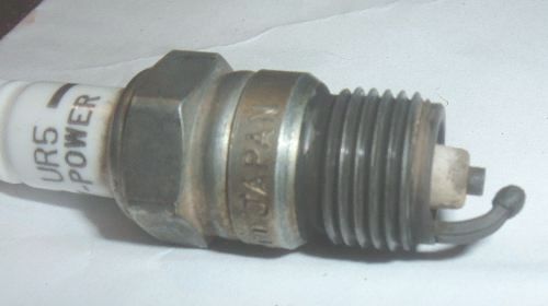

But here is a pic of the #3 Plug .... got pretty hot.
1 and 5 looked good, haven't pulled 2,4,6 yet.....not looking good !!

Report this Post09-06-2006 11:35 AM Click Here to See the Profile for DodgerunnerClick Here to visit Dodgerunner's HomePageSend a Private Message to DodgerunnerDirect Link to This Post
Is the end of the electrode melted? Look like that cyl. is running real lean.
Got a plugged injector?

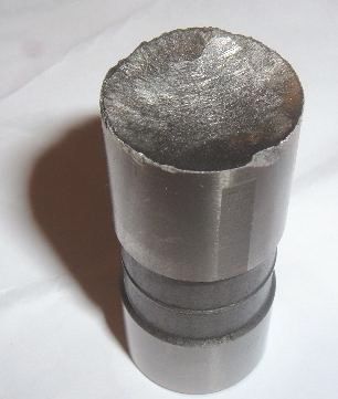

Well, I have unfortunatly found the problem and it is not what I wanted to see.
One of the lifters failed as you can see in the pic and both cam and lifters will have to be replaced.
All the rest of them looked good, I can not push the plunger down at all so it is my opinion that it failed.
Boy did it do a number on the cam lobe !!! Looks like I will be pulling the motor once again....
Oh man!
I hate to see that. That just sucks big time!
It frightens me even worse as I have the same cam (I'm guessing you also bought the matching Crane lifters) as you.
It's making me rethink the whole thing. Or making me think about using GM lifters, at the least.

Report this Post09-07-2006 06:13 PM Click Here to See the Profile for AP2kSend a Private Message to AP2kDirect Link to This Post
Good night! Is that wear on the side of it too?
If you are talking about that long flat spot on the side ,it is the way the lifter is made.
If you are talking about the edges of the area that is worn, that is where small pieces of the metal chipped off.

Originally posted by Raydar:
Oh man!
I am going back with the same ones....I believe it was just a case of bad luck and I got the one bad lifter !!
Only thing I am wondering...what is the likely hood it may have damaged the valve also. Top of the valve train , spring and all looks good and the push rod was not even bent or beat up on the ends. I guess the only safe thing to do is go ahead and pull it for peace of mind. Its still going to put me out of pocket at least a $100 for fluids and gaskets.
I'm thinking the valve is probably okay. Leave both valves closed and pressurize the cylinder. I used my air compressor and the hose off my compression tester. If the cylinder will hold air without hissing into the port (was it an intake or exhaust valve?) I'm thinking everything will be okay.
If someone disagrees, I won't argue. Just MHO.
FWIW, your symptoms sounded very similar to when I broke a rocker stud on an exhaust valve. Whenever I stepped on the gas it would make a WUB-WUB-WUB-WUB sound, that was actually coming from the intake, along with the occasional backfire.
Edit -- You know that there's got to be little bits of metal everywhere inside your engine, now. At least up to the oil filter.
At least remove and flush your oil pump and check the output side of your oil filter. If it didn't clog up and go to bypass, everything past the filter may be okay. Except for what hasn't washed down to the pan, yet.
