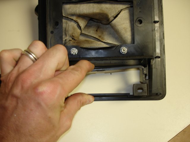

I dont know if anyone else has done it this way but here goes...I was so happy to figure it out I just had to share.
After breaking numerous lids (7) trying to remove them to restore...I came across this overly simple solution which had been staring me in the face all this time. This method requires NO tools...just your fingers.

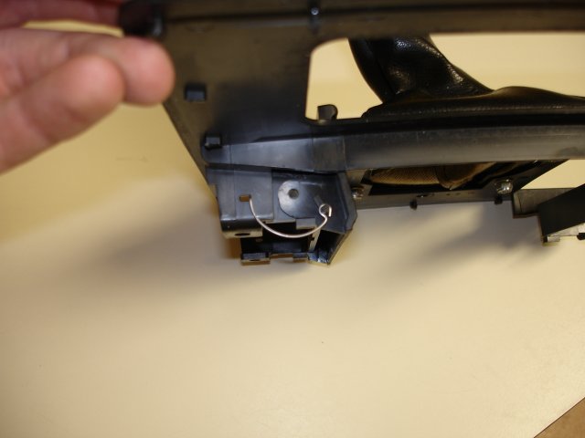

First Remove the retaining spring...

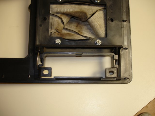

Then take a look at the piece of plastic that runs the length of the ash tray door...
Place fingers as shown and bend the plastic. Keep in mind if yours is seriously deteriorating then it could crack...none of mine were that bad so this method worked well.
This will "pull" the sides in just enough to wiggle the lid off of the very tiny and fragile studs..thats it! Done! And without breaking the lids or studs....to install just do this in reverse!
